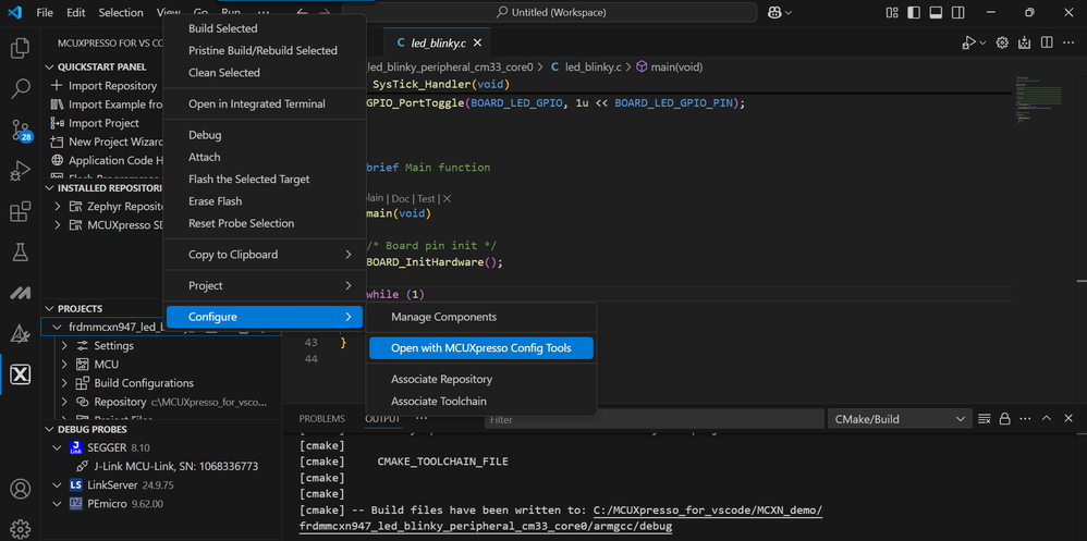

3. From VSCode, right click on led_blinky and start using the config tool.
4. As soon as it opens, the Config tool is reporting many errors in Clocks and Pins. (around 20 errors). I'm new with NXP, MCUXpresso, and VSCode so I don't know how to proceed.

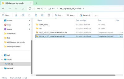

1. Download the 24.12 SDK from Select Board | MCUXpresso SDK Builder
2. After the download is completed, place the SDK in the created directory C:\MCUXpresso_for_vscode.

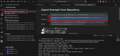

3. Select the "LOCAL ARCHIVE" method to import the repository.  
Choose "Import Repository" -> "LOCAL ARCHIVE" -> "Archive" -> "Browse", then locate the SDK folder downloaded from the SDK Builder. Select the built "SDK_24_12_00_FRDM - MCXN947".
4. Create a new empty folder and name it "MCXN947". Click "Destination" -> "Browse" and select the newly created "MCXN947" folder. Then click "Import", and the SDK will be automatically imported.
5. Click "Import Example from Repository" to import the project "led_blinky" and create a new project.

Well, this time it worked. You will see the screenshots above.
I do see that your Configuration Overview does not show the errors that I am getting. I wish my Overview screen looked like yours does!
I don't know how to confirm Config tools is successfully installed. As far as I can tell, it appears to be working. I do get a Config Tools Overview screen which is similar to yours, but there are still a lot of difference. I hope when you see the differences between the Config Tools Overview screens, it will help you determine what is going wrong. In the mean time, I will uninstall my Config Tools program and reinstall it from your web site.

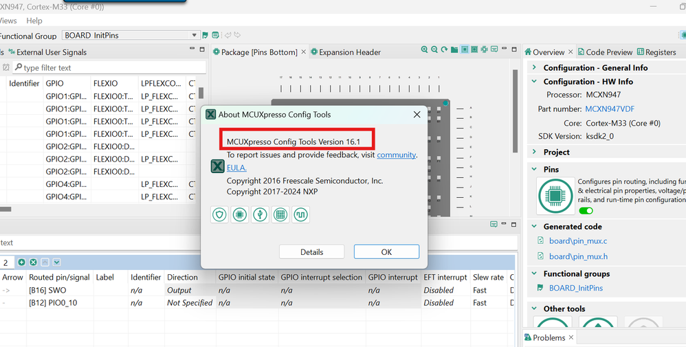

Config Tools: v16.1
SDK: 24_12_00, SDK_2_16_100
I've tried the led_blinky in both versions of the SDK, and there were no issues.

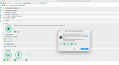

ClarkS

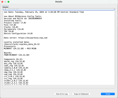

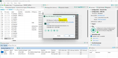

@Celeste_Liu
We have different versions of Config Tools.
I have 24.12. You have 16.1.
I got mine from here: https://www.nxp.com/design/design-center/software/development-software/mcuxpresso-software-and-tools...
Would you be able to test with the later version? 
My SDK is 24.12.10. You have both SDK: 24_12_00 and SDK_2_16_100.

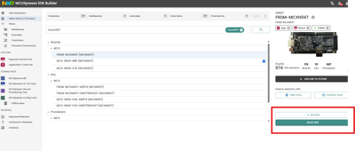

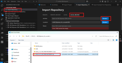

ClarkS
@Celeste_Liu
Congratulations! The repo you advised me to obtain does not show any Config errors! Thank you for spending as much time as you did to help me with this problem!
Is it always best to obtain archives from the SDK builder rather than Github? I'm pretty sure the IDE recommended Github. Perhaps it should recommend the SDK builder.

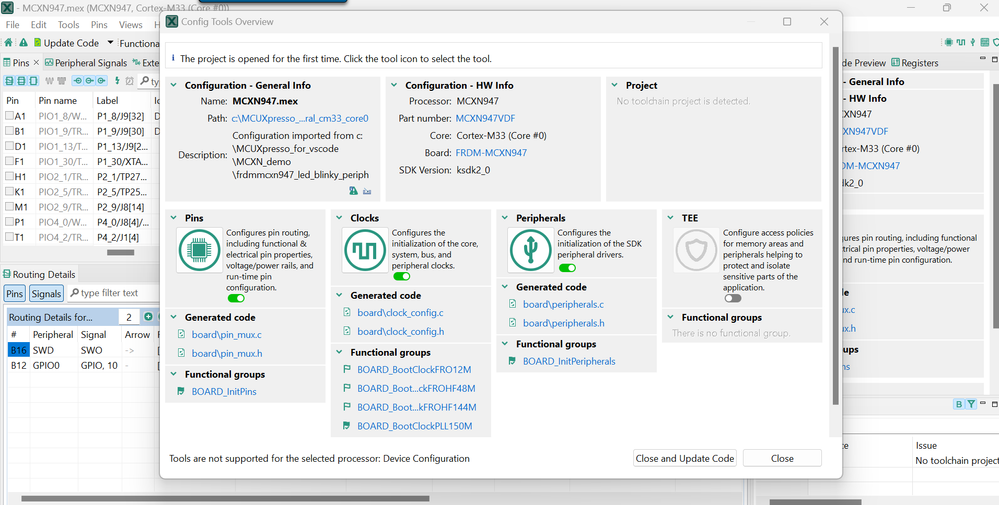

ClarkS
I've added a couple screen shots. I've marked the various error related areas on each screen shot.
Two types of errors are shown.
1. The Device Configuration error which seems to say the Config tool does not support the processor used on the MCNX947. I think I misunderstand the meaning of this error.
2. Missing driver errors.  I cannot find those drivers in my SDK repo. Maybe those file names (COMMON, PORTR, CLOCK, etc) are generic names and not actual file names. If that is the case, I have no idea how to find the actual file name, nor is it clear to me how to add drivers to the project using VS Code or the Config tool.
