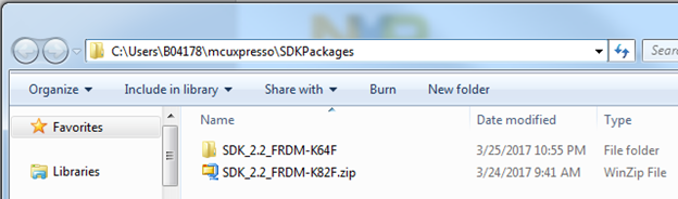

When an MCUXpresso SDK zip package or folder is drag-and-dropped into the IDE, a copy of that zip/folder is made and put into the C:\Users\<user_name>\mcuxpresso\SDKPackages directory. Thus you can delete the original copy that was downloaded to save disk space.

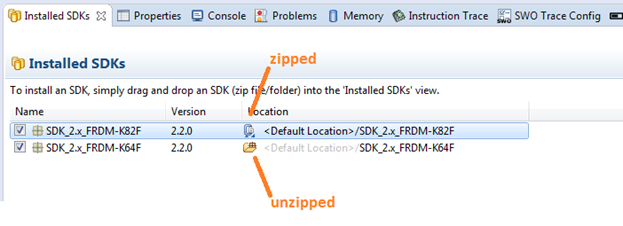

If the imported SDK was zipped, then when creating or importing example projects, the SDK source files are always copied into the workspace. If the imported SDK was unzipped, then you are given the option to either copy the SDK source files into the workspace (which is the default), or the SDK files can be referenced directly as linked references.

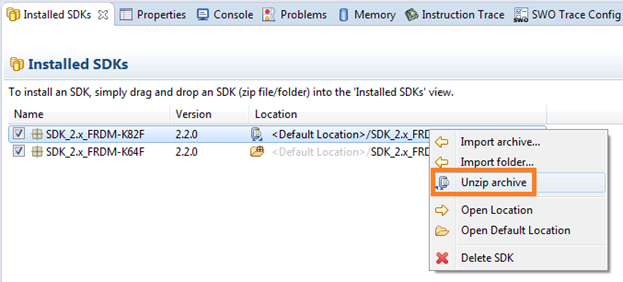

If an SDK is imported as a zipped file, it can be later unzipped from inside the MCUXpresso IDE. This unzipping has been optimized so it’s much faster than unzipping it via a program like WinZip. When unzipping inside the MCUXpresso IDE, the zip file that was in the MCUXpresso SDKPackages folder will automatically be deleted from the hard drive once its finished unzipping. You can then use this unzipped folder for that SDK location when using the MCUXpresso Config tools.

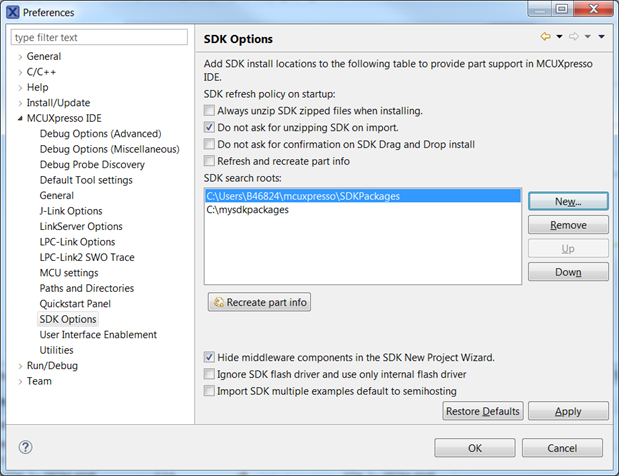

Finally you can also specify additional directories that MCUXpresso IDE should search for SDK files (both zipped or unzipped) by going to Window -> Preferences -> MCUXpresso IDE -> SDK Options. This can be useful for keeping a repository of SDKs in a special location on your hard drive. For SDKs stored outside the default location though, the "Delete SDK" function is disabled inside the IDE, and the extra search paths are only saved per workspace, so if you choose another workspace, it won't know about the new SDK folders until you re-add the path. If multiple SDKs are found for the same device in different locations, the IDE select the package to use by priority on the list (top has priority).
