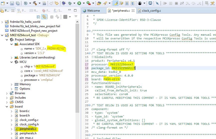

It could be the case that you are facing an error like this:

4,666 次查看
diego_charles
if you obtained the same error window than me:
You may want to try the following:
Go to file (project-> board->peripherals.c) and replace references from KE15Z to KE16Z
for the following ones
processor: MKE16Z64xxx4
package_id: MKE16Z64VLF4
board: FRDM-KE16Z
