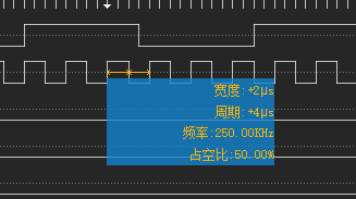

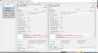

Hey,   Recently while i use MCUXpressoIDE & MCUXpresso Config Tools to generate GPT1 & GPT2 configurations automatically for my project, I found out there may be something incorrect about `compare value`, showing as follows:
And my IRQ shows like this:

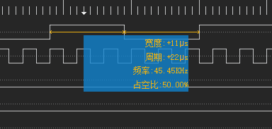

Then I captured the pin logic, like this:
Then I realized that same thing happened before while i use the same processor and same gpt, which is that the actual compare value is 1 more than its setting value, while it cannot be set as zero in MCUXpresso Config Tools(showing as follow). So it leads to one more microsecond for every microseconds.(I guess.)
So, I am a little confused. Am I right about this?
