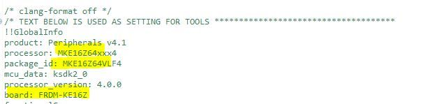

diego_charles
if you obtained the same error window than me:
You may want to try the following:
Go to file (project-> board->peripherals.c) and replace references from KE15Z to KE16Z
for the following ones
processor: MKE16Z64xxx4
package_id: MKE16Z64VLF4
board: FRDM-KE16Z

claudiobrunelli
I diego, my apologies for delay.
I was busy a lot. Thanks for your answer. We found out what's wrong. We discovered that mcuxpresso has something wrong in the sdk for kea16z. Infact the clock tool doesn't work with the sdk wired to the freedom board. It has the problem. But on the countrary if you use the sdk for the microcontroller only the tool works properly.
