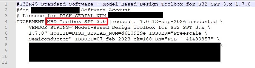

iulianbulancea
Hello @Vamsi_Sirigina ,
Can you install a patch of the toolbox found here? Please save and use the license file that you have.

Vamsi_Sirigina
Great!!!!Thank you @iulianbulancea ..:)
it working fine now

iulianbulancea
Can you run example_add_mex_spt31.m and send me the error?
Also, can open the license file and send me the license feature? The feature is a word in the license file that you can find here:
