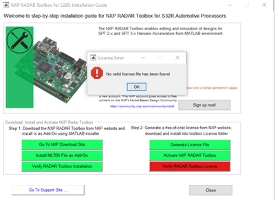

Hi, warm Greeting!! , Could you please me on below issue
I have installed  NXP RADAR SPT toolbox 3.0x 1.7.0 version
matlab version 2022b.
facing license error :
#MBDT

Vamsi_Sirigina
>> example_add_mex_spt31
Error using pbrstg
Flexnet failed to check the license:
1) For feature "MBD_Toolbox_SPT_3.0" due to:NOFEATURE - No such feature exists.
Error in example_add_mex_spt31 (line 60)
switch_spt(31);
License.dat
#Model-Based Design for SPT - Model-Based Design Toolbox for S32 SPT 3.x 1.7.0
#for vamsi sirigina Software Account
# License for DISK_SERIAL_NUM=XXXXXXXXXX
INCREMENT MBD_Toolbox_SPT freescale 1.0 25-feb-2033 uncounted \
VENDOR_STRING="Model-Based Design Toolbox for S32 SPT 3.x \
1.7.0" HOSTID=DISK_SERIAL_NUM=8c74f48f ISSUER="Freescale \
Semiconductor" ISSUED=13-sep-2023 ck=186 SN="FSL - 3355348" \
TS_OK SIGN="14B9 B8F0 CAD6 A593 C28F C850 65B6 339C 7D72 841F \
F584 D329 F3FC 4B6D E43E 0F5F 8AFB 69F3 59E2 D62B 97FC 366A \
8B5C 045D 975C 590C 3AF5 3601 DA41 BAA7"
Thankyou @iulianbulancea

Hello @Vamsi_Sirigina ,
Can you install a patch of the toolbox found here? Please save and use the license file that you have.
Thank you,
Iulian Bulancea
8,767 Views
Vamsi_Sirigina
Great!!!!Thank you @iulianbulancea ..:)
it working fine now
