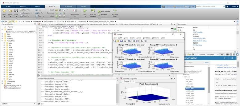

Model-Based Design Toolbox for SPT allows fast prototyping of algorithms that handle sampled RADAR signals directly from MATLAB environment via SPT bit-exact Simulator.
