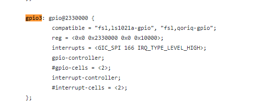

(1)Why there is a gpio3 there at the node section, what does that use for?

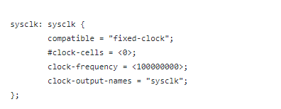

(2)And why sysclk doesn't have a cell for address register because sysclk isn't a memory I/O device?

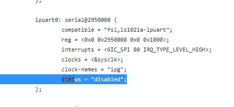

(3) Also the status section
can this be inside of the .dtsi as well, I thought this can only be inside of the .dts file only to disable or enable the node.

1. It is used to define GPIO module.
2. Yes, sysclk isn't a memory I/O device.
3. Status can be used inside of the .dtsi.
