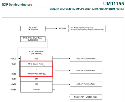

I'm not sure if this is a feature that is rarely used.
Is "LPC54S018M.h" wrong?
According to the specification, RESERVED_0 (= Ptr to DeviceTable) is 12 words.
 B.R.
1,619 Views
yo_ku_
Sorry.
I was able to confirm that RNG_GetRandomData() (it uses the OTP_API) works on RESERVED_0[13].
Perhaps the specification is wrong.
