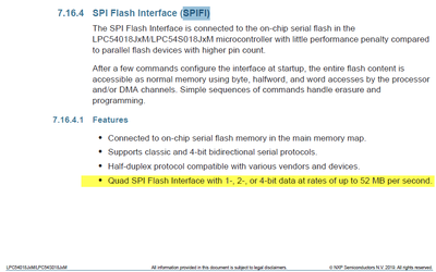

The example spifi source code from mcu-boot initializes the spifi clock speed to 24MHz. Is this NXP's recommendation for the spifi clock speed for spifi flash in LPC54S018J4M? I was wondering if a higher clock rate would be safe to use. Please advise.

According to Datasheet,
Quad SPI Flash Interface with 1-, 2-, or 4-bit data at rates of up to 52 MB per second.

Thank you for responding. 52MB/s data rate is not the same as the clock frequency, as it could take into account 4-bit data. Could you advise what the highest allowed clock frequency should be for spifi flash?

According to UM
Transfer rates of up to SPIFI_CLK/2 bytes per second. This is for 4bit data.
According DS,
Quad SPI Flash Interface with 1-, 2-, or 4-bit data at rates of up to 52 MB per second. the maximal 52MB is for 4bit data
So we can say maximal SPIFI_CLK is 104MHz.
Here is SPIFI clock source
If you choose internal FRO96,
  for 4bit data, maximal rate is 96/2=48MB,
  For 1bit data, maximal rate is 96/8=12MB
to get 52MB maximal rate, you need use external clock and configure PLL to reach 104M SPIFI_CLK.
