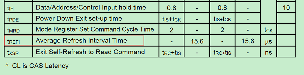

Hui_Ma
I check the Max. refresh interval time below at AS4C4M16SA datasheet:
There are some application notes about SDRAM design with LPC EMC module:
AN11508: SDRAM interface to LPC18xx/43xx EMC
− Comprehensive information about connecting EMC to different SDRAMs
− Some advanced skills like clock compensation options
− PCB layout guide
AN10771: Using the LPC24xx EMC peripheral to drive SDRAM
− Similar as AN11508, but early and simpler document
Wish it helps.
