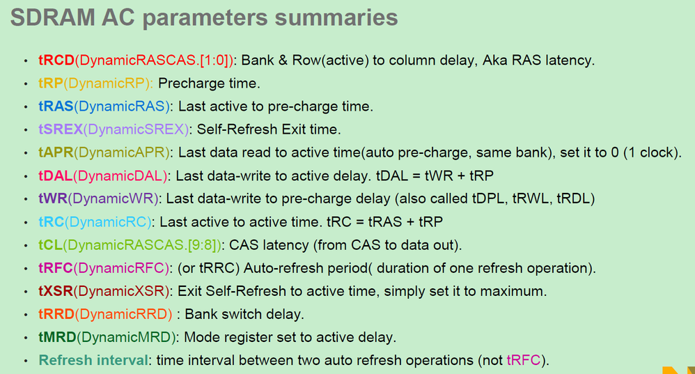

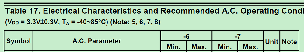

I check the Max. refresh interval time below at AS4C4M16SA datasheet:
There are some application notes about SDRAM design with LPC EMC module:
AN11508: SDRAM interface to LPC18xx/43xx EMC
− Comprehensive information about connecting EMC to different SDRAMs
− Some advanced skills like clock compensation options
− PCB layout guide
AN10771: Using the LPC24xx EMC peripheral to drive SDRAM
− Similar as AN11508, but early and simpler document
Wish it helps.

First of all, thank you for the patience.
Please check below definition about SDRAM timing:
I checked the SDRAM timing value with below concerns:
#define SDRAM_TRP_NS (21u)      From AS4C4M16SA datasheet the value should be 18u;
#define SDRAM_TSREX_NS (67u)  is Self-Refresh Exit time, tRC+tIS = 60+1.5 , which should be 62u;
#define SDRAM_TAPR_NS (20u)   the value is 18u;
#define SDRAM_RRD_NS (14u)     should be 12u;
When you slow down the SDRAM clock frequency, if the issue happen probability reduced?
Mike
