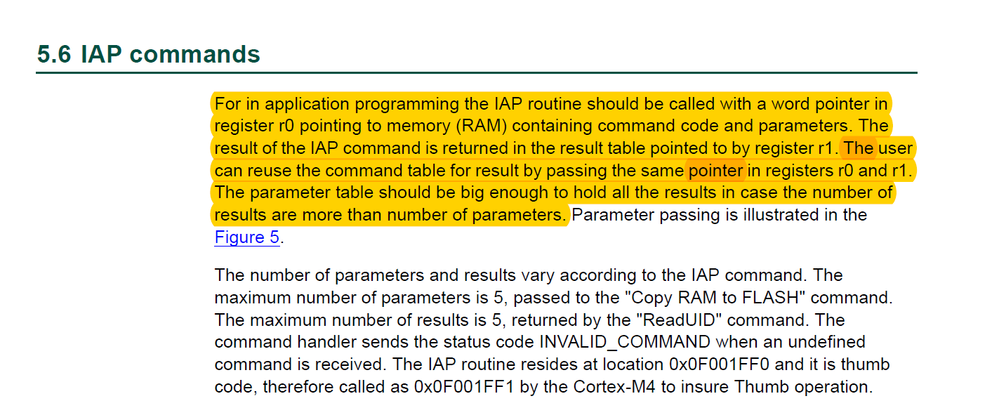

I have been working with the LPCXpresso845MAX board and discovered an issue interfacing to the IAP ROM routines.  Following the User manual UM11029 Rev 1.6 in section 5.6 the sentence in opening paragraph says 'The user can reuse the command table for result by passing the same pointer in registers r0 and r1.'.  When doing this I was continuing to get INVALID_COMMAND returned.
But if I do not use the same buffers for input and output then the command succeed. Reading through these forums this appears to be similar to an issue reported on the LPC824.
So my question becomes is this a User manual documentation issue or a boot ROM issue and will be fixed in a furture variant of the micro-controller?

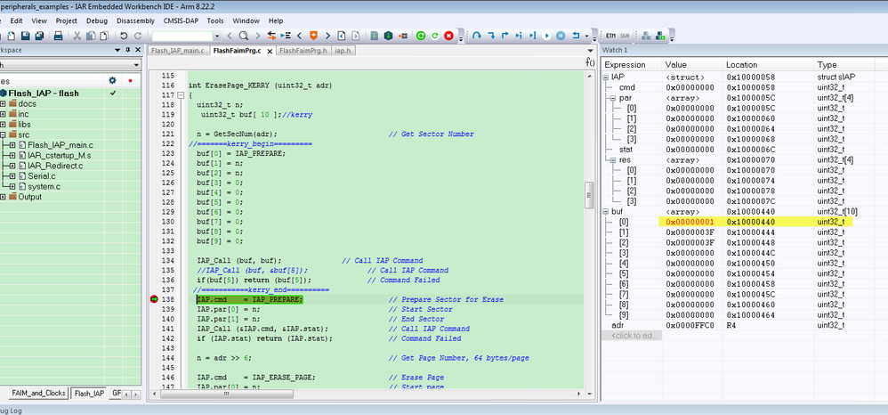

  Today, I have test the doc description, with the same point :
For meet the big enough demand, I define the code like this in the codebundle IAP example, mainly test ErasePage API:
int ErasePage_KERRY (uint32_t adr)
  uint32_t n;
   uint32_t buf[ 10 ];//kerry
  n = GetSecNum(adr);                          // Get Sector Number
//=======kerry_begin=========
  buf[0] = IAP_PREPARE;
  buf[1] = n;
  buf[2] = n;
  buf[3] = 0;
  buf[4] = 0;
  buf[5] = 0;
  buf[6] = 0;
  buf[7] = 0;
  buf[8] = 0;
  buf[9] = 0;
  IAP_Call (buf, buf);              // Call IAP Command
  //IAP_Call (buf, &buf[5]);              // Call IAP Command
  if(buf[5]) return (buf[5]);             // Command Failed
 //===========kerry_end==========
  IAP.cmd    = IAP_PREPARE;                    // Prepare Sector for Erase
  IAP.par[0] = n;                              // Start Sector
  IAP.par[1] = n;                              // End Sector
  IAP_Call (&IAP.cmd, &IAP.stat);              // Call IAP Command
  if (IAP.stat) return (IAP.stat);             // Command Failed
  n = adr >> 6;                                // Get Page Number, 64 bytes/page
  IAP.cmd    = IAP_ERASE_PAGE;                 // Erase Page
  IAP.par[0] = n;                              // Start page
  IAP.par[1] = n;                              // End page
//  IAP.par[2] = SystemCoreClock / 1000;         // CCLK in kHz
  return (0);                                  // Finished without Errors

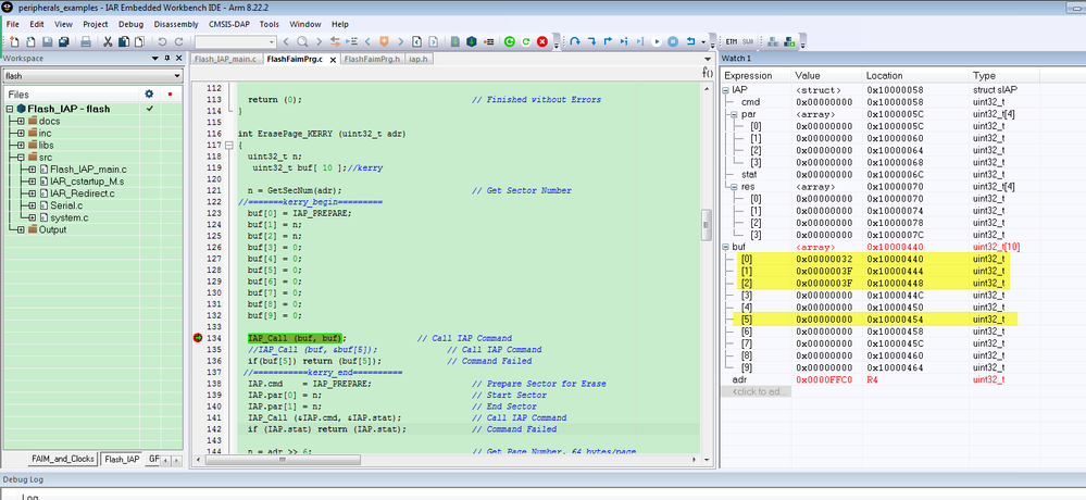

Then the test result like this:
1. before call the IAP_Call(buf,buf), with the same point:
2. after call the IAP_Call(buf,buf), with the same pointer:
The returned value is wrong, I think this 0x01 should be the status, although I judge buf[5].

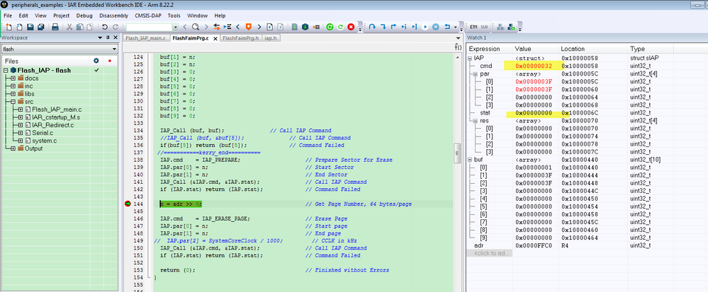

Then Run the code with different pointer:
So, the result just like what you have side, it should be the doc problem,it can't use the same pointer.
