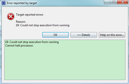

I need to power down the Ethernet PHY on my Embedded Artists' LPC4088QSB (QuickStart Board), in order to reduce the current draw. I've got some code which seems to do it, and reduces the current draw by (very) roughly 40 mA. But executing this code breaks debugging in a very strange way.
I'm using Mbed OS 5.7.5 in MCUXpresso. I describe further below how to check out and setup the project. But first I detail the issue.
Here is my test code where I demonstrate the issue:
GitHub - bmcdonnell-ionx/eth-dbg-issue
Is this the right way to power down the PHY? Why is it breaking debugging, and how can I fix it? Details follow.
Problem Description
The problem goes like this:
  • Once phy_write(PHY_REG_BMCR, PHY_BMCR_PWR_DOWN); is called in main.cpp, and then after a reset or power-cycle, and after the code gets past the first for loop in ethernet_init(), you will no longer be able to debug. (i.e. The debugger can't halt the micro anymore, so you can't single step, "run to", or the like.)
    • This issue persists even after reset or power cycle. (Meaning you lose the ability to halt the micro once you pass that place inside ethernet_init().)
  • The only way I've found to fix the issue is as follows:
    • Power cycle the board so that you'll be able to halt the micro again (initially).
    • Erase the micro flash.
    • Power cycle the board again.
    • Now you'll be able to debug normally - until you pass that phy_write() call again.
I tried debugging with the on-board debugger, and with a separate LPC-Link2; results were the same.

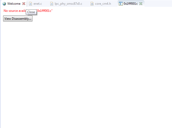

jeremyzhou
Hi Brendan McDonnell,
I've done the more testing with IAR and LPCXpresso IDE and let me demonstrate the testing result.
The demo code is periph_ethernet demo which is from the LPCOpen library, as I can test with different IDE and I'm not family with the Mbed OS 5.7.5. And the Eva board is LPC4088 OEM board and debug tool is LPC-Link 2.
In both of LPCXpresso and IAR IDE, the debug behavior will be lost when click restart button after executing the power down the PHY: LAN8720, as the Fig 1and Fig 2 show.
Fig 1
Fig 2
To recover the debug behavior, I should repower the board and external debugger, then breakpoint feature will become available, in another word, I've not encountered the issue like yours.

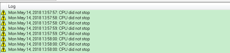

About the new issue you talked about, I can replicate the issue you describle, the debugger will lost its behavior during initializing the Ehternet module and PHY chip.
Fig 3
To recomever it, clicking terminate all debug sessions button to stop the current debug behavior, then start a new round of debugg.
