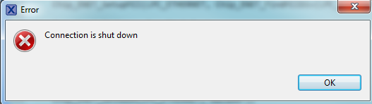

I've done the more testing with IAR and LPCXpresso IDE and let me demonstrate the testing result.
The demo code is periph_ethernet demo which is from the LPCOpen library, as I can test with different IDE and I'm not family with the Mbed OS 5.7.5. And the Eva board is LPC4088 OEM board and debug tool is LPC-Link 2.
In both of LPCXpresso and IAR IDE, the debug behavior will be lost when click restart button after executing the power down the PHY: LAN8720, as the Fig 1and Fig 2 show.
Fig 1
Fig 2
To recover the debug behavior, I should repower the board and external debugger, then breakpoint feature will become available, in another word, I've not encountered the issue like yours.
About the new issue you talked about, I can replicate the issue you describle, the debugger will lost its behavior during initializing the Ehternet module and PHY chip.
Fig 3
To recomever it, clicking terminate all debug sessions button to stop the current debug behavior, then start a new round of debugg.

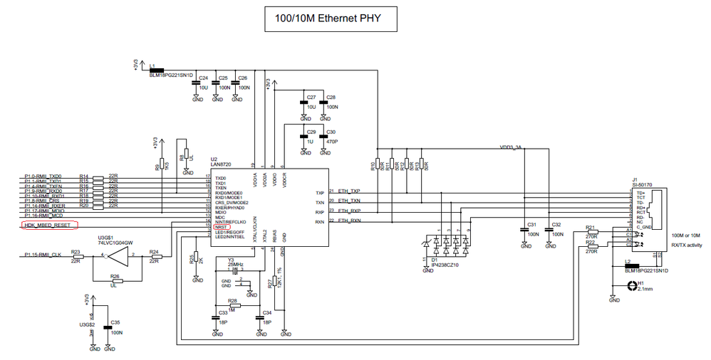

I don't have the LPC4088 QuickStart board on hand, and in the OEM board, the PHY chip is LAN8720 (please checking the attachment),so I believe it's Okay to test with this board and I'd highly recommend you to do some testing with LPCOpen library on LPC4088 QuickStart board.
TIC
21,246件の閲覧回数
bmcdonnell_ionx
Thanks for the schematic. The PHY circuits and connections to the micro look about the same, except for a few resistor values, and the diode network between the PHY and the Ethernet port on the QSB.
Did you try phy_write(PHY_REG_BMCR, PHY_BMCR_PWR_DOWN) to power down the PHY, and then NVIC_SystemReset()? What was the result? Were you able to get through PHY initialization after the reset?

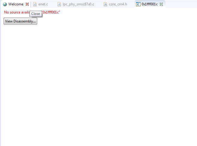

jeremyzhou
Hi Brendan McDonnell
The code running can't stop or be halted after executing the phy_write(PHY_REG_BMCR, PHY_BMCR_PWR_DOWN)  and NVIC_SystemReset(), it needs to click terminate all debug sessions button to recover(Fig 1).
                                                                    Fig 1
Then enter the debug model again, the code running can stop at breakpoints and be halted after initializing the external PHY.
TIC

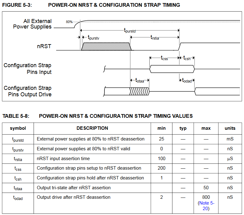

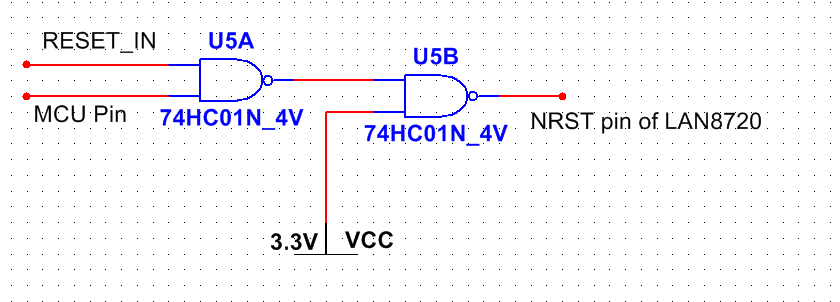

jeremyzhou
Hi Brendan McDonnell,
To implement it, in addition to the reset button, you need to add a hard reset trigger for LAN8720, as the Figure 1 illustrates.
As we know, the MCU will re-enter main.c after calling NVIC_SystemReset(), it's available to use a GPIO pin to emulate a Reset button to reset the LAN8702 before initializing it, as software reset doesn't pull know the reset pin.
Fig 1
And on page 59 in the datasheet, it demonstrates the boot process of LAN8720, it would help you to emulate the hardware reset.
Fig 2
Hope it helps.

jeremyzhou
The Fig 1 seems like a ultimate solution, for the Embedded Artists' LPC4088QSB, it needs to remove the R2 prior to pull down the NRST pin, as in this way, the artificial reset trigger is effectless to the MCU.
Hope this is clear.
