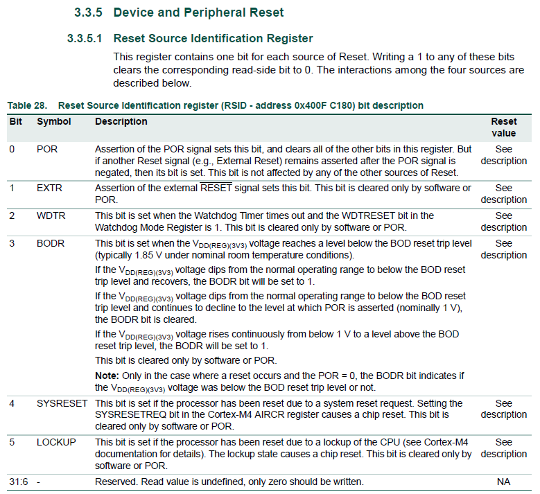

jeremyzhou
Hi McDonnell,
It's available to detect the reset source by checking the RSID register(Reset Source Identification register), so you can skip the "safe shutdown" sequence to execute the MYSTERY_COMMAND();  when a software reset is identified.
TIC
