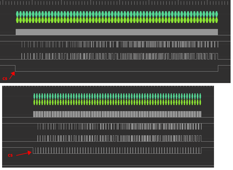

Hi.I have an SPI issue, may I know how to handle it? The official routine spi_transfer_rma_stlave calls the EXAMPLE_MasterStartDMATransfer() function twice in a row in the main function. The captured SPI waveform shows that the second transfer will raise the CS for each data. We need to send data for the second time, and only raise CS after the data is sent. It's not like raising CS every time we send data

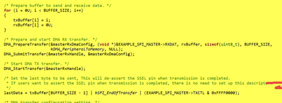

void EXAMPLE_MasterStartDMATransfer(void)

How can I modify this function? Or add other configurations? Thank you.

I don't know why I called this function twice. The first time I called this function to send data, CS was pulled down during the entire data transmission process. The second time I called it, CS was indeed pulled up for each data transmission.que.jpgque.jpg

xiangjun_rong
As the following screenshot,
EXAMPLE_MasterStartDMATransfer();
is called only once.

JZhang24z
yes,demo is called once.
But. I need to modify this demo by calling this function multiple times. How can I avoid a second call where the master sends a data and then raises the CS value? For example. I need to send 8 bytes of data, and I hope to send all 8 bytes of data before raising the CS. The current practice is to go to the initial SPI(EXAMPLE-SPIMasterInit()), before call this function;... It shouldn't be used that way, right?
