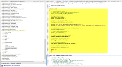

As the following screenshot,
EXAMPLE_MasterStartDMATransfer();
is called only once.

JZhang24z
yes,demo is called once.
But. I need to modify this demo by calling this function multiple times. How can I avoid a second call where the master sends a data and then raises the CS value? For example. I need to send 8 bytes of data, and I hope to send all 8 bytes of data before raising the CS. The current practice is to go to the initial SPI(EXAMPLE-SPIMasterInit()), before call this function;... It shouldn't be used that way, right?
