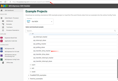

I don't know why I called this function twice. The first time I called this function to send data, CS was pulled down during the entire data transmission process. The second time I called it, CS was indeed pulled up for each data transmission.que.jpg
5,810件の閲覧回数
xiangjun_rong
As the following screenshot,
EXAMPLE_MasterStartDMATransfer();
is called only once.
XiangJun Rong
5,800件の閲覧回数
JZhang24z
yes,demo is called once.
But. I need to modify this demo by calling this function multiple times. How can I avoid a second call where the master sends a data and then raises the CS value? For example. I need to send 8 bytes of data, and I hope to send all 8 bytes of data before raising the CS. The current practice is to go to the initial SPI(EXAMPLE-SPIMasterInit()), before call this function;... It shouldn't be used that way, right?
5,794件の閲覧回数
xiangjun_rong
If you want to call the function multiple times, you have to poll if the predefined number of data has been transferred, after the DMA transfer completed, then you can call again.
