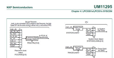

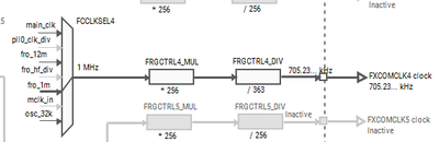

ref the diagram that I included here...
The Multiplier on FXCOMCLK4 doesn't want to be anything other than 256 in this tool and the divisor only goes up to 511 so I can't bring fro_12m into anything reasonable as a clock rate on that line.
However, my pll0 is running at 96MHz (derived from fro_12m) so I turned on pll0_clk_div and divided that down to 1Mhz and used that as input to FCCLKSEL4 to get me the same (sort of close) clock rate.
Didn't' change the odd clock stream at all.
HOWEVER: when I changed the divisor in FXCOMCLK4 to 256 (so that whole scale thing is 1) and then changed the pll0_clk_div to 136, I now get a good clock!
So somehow this FRGCTRL4 is hosing the output clock.  No idea why but it really doesn't like to be set up how I set it up.

the I2S sampling rate is 22.05KHz, the bit width in one slot is 16 bits, the bit clock is 22.05KHz*16*2=705.6KHz, you use FRG to get 705.6KHz from 1M internal clock, maybe it is the root cause for the discontinuous bit clock.
I suggest you use FRO12MHz, 12MHz/705.6KHz=17, you can set up the FRG divider as 1(set up the MULT to be 0), ans set up the I2S prescaler as 17, I suppose that the I2S bit clock will be continuous.
Pls have a try

xiangjun_rong

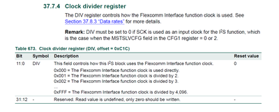

First of all, the DIV bits of FRG must be 0xFF or 256 as the following Remark.
Remark: To use the fractional baud rate generator, 0xFF must be wirtten to the DIV value
to yield a denominator vale of 256. All other values are not supported. See Section 34.3.1
“Configure the Flexcomm Interface clock and USART baud rate” and Section 34.7.2
“Clocking and baud rates”.
Secondly, there is a divider for the I2S driving clock, the FRG can generate the clock frequency for your application such as x*705.6KHz and set up the I2S divider as x and use the I2S divider to divide it to 705.6KHz.
Hope it can help you
XiangJun Rong
