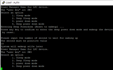

I powered the LPC55S06 EVK Board from USB Micro B Plug J1.
I loaded the *lpcxpresso55s06_power_manager_lpc* demo.
The SDK is V2.12
I measured the current across the J20 jumpers (VBAT) on the board.
Normal Mode: 28mA
Deep power down mode: 24mA
My Question: why does the current get not lower?
I expect VBAT current must be some uA.
What am I doing wrong?
Thanks for your help.

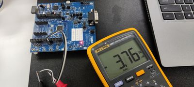

Hello @alexanderhaenel
From the terminal output, it seems your chip have wakeup, it is should be in active mode (normal mode) .
While I think maybe your board broken, because even though it in active mode, the power consumption is so high. I check on my side, when it in active mode, the Power consumption is 3.76ma:

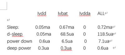

Below is the result I measured before, while pay attention, I use the demo lpcxpresso55s06_power_manager_lpc,  Did not disable pull-up/pull-down.

alexanderhaenel
Hello @Alice_Yang
here comes the requested informations:
The picture:
The code to run into deep mode is your SDK example: “power_manager_lpc”

The terminal output:
BR Alexander
6,289 Views
