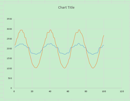

   I have used LPC54608J512BD208 microcontroller in protection relay. The external input voltage is stepped down,superimposed on a 1.65V DC signal and fed to the ADC input of microcontroller. I am using 6 ADC channels namely ADC0_0, ADC0_4, ADC0_5, ADC0_6, ADC0_7 & ADC0_8. The controller is driven by an external crystal of 16 MHz stepped up through PLL to 100 MHz. The following are the connections to adc pins:
I am getting no fluctuations when passing only DC signal at the ADC.
ADC gives distorted output when AC signal is superimposed on DC signal and applied to ADC.
I have observed the waveforms at ADC input pin without any distortion on a DSO.
I have attached my project, ADC samples and controller schematic for reference. Please help in resolving this issue.

jeremyzhou
Hi Prasanna Naik,
In your ADC_Test_Reslut.xls, it presents the signal which is superimposed on a 1.65V DC signal, these two lines are not only different but also both of them are a bit distorted.
So I'd like to suggest that you increase the sampling frequency and sample point to rebuild the signal. In further, I had done similar testing before, it may give you an insight into this phenomenon.

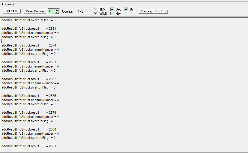

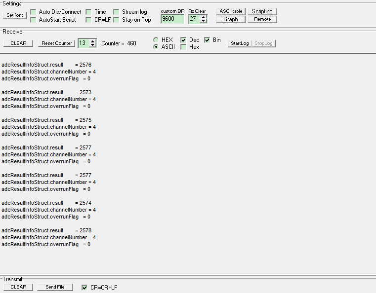

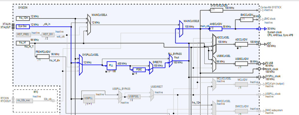

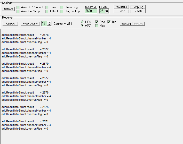

Hi Prasanna Naik,
Thanks for your reply.
I've used the ADC channel4 pin to convert a 2.07V DC signal and the testing result is presented below.
Board: OM13092, demo project: lpcxpresso54608_lpc_adc_basic (From the SDK library)
1) async clock 80 MHz:
Clock tree:
ADC conversion result:
2) async_clock_100MHz:
Clock tree:
3) sync_clock_80MHz
Clock tree:
4) sync_clock_100MHz
Clock tree:
5) sync_clock_50MHz
Clock tree:
Conclusion: These results are almost the same actually.
