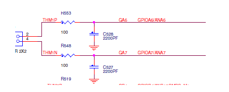

From hardware, I suggest you connect a RC(100 ohm and 2.2nF cap) circuit on each ADC analog channel.
As you know that the ADC sample fluctuation is complex, I do not guarantee it can solve the issue. anyway, pls have a try.
