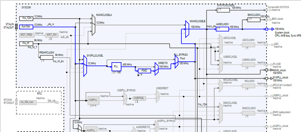

I've used the ADC channel4 pin to convert a 2.07V DC signal and the testing result is presented below.
Board: OM13092, demo project: lpcxpresso54608_lpc_adc_basic (From the SDK library)
1) async clock 80 MHz:
Clock tree:
ADC conversion result:
2) async_clock_100MHz:
Clock tree:
3) sync_clock_80MHz
Clock tree:
4) sync_clock_100MHz
Clock tree:
5) sync_clock_50MHz
Clock tree:
Conclusion: These results are almost the same actually.
