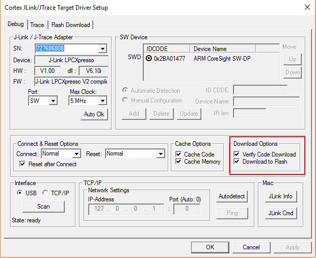

One thing I had to do was to remove JP5. It was installed at delivery (manual says it is open by default) and Keil would not see the DAP. Once JP5 was removed, all worked :smileyhappy:
Important note!    The boards don't necessarily come with the CMSIS-DSP debugger.    Mine came with the J-Link firmware.    The project settings need to be changed to use the J-LINK.   Also,  the SDK projects don't have the "Download to flash and Verify" check boxes set in the "Download options" when using the Keil tools.
