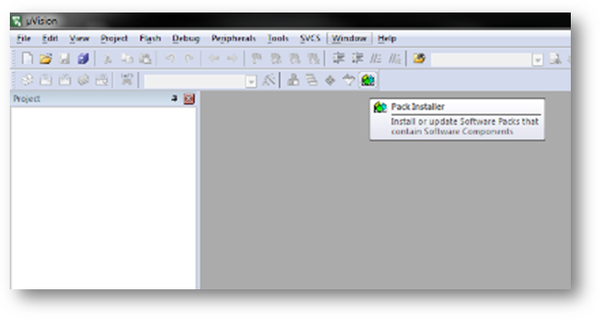

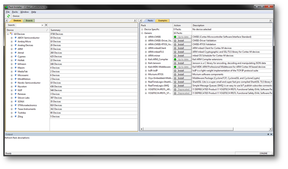

Before we start utilizing uVision we must make sure that we have the relevant packs installed to work with the LPCXpresso54608 board.
Select the Pack Installer on the toolbar.
The Pack installer shows you which parts and boards for which you have support.

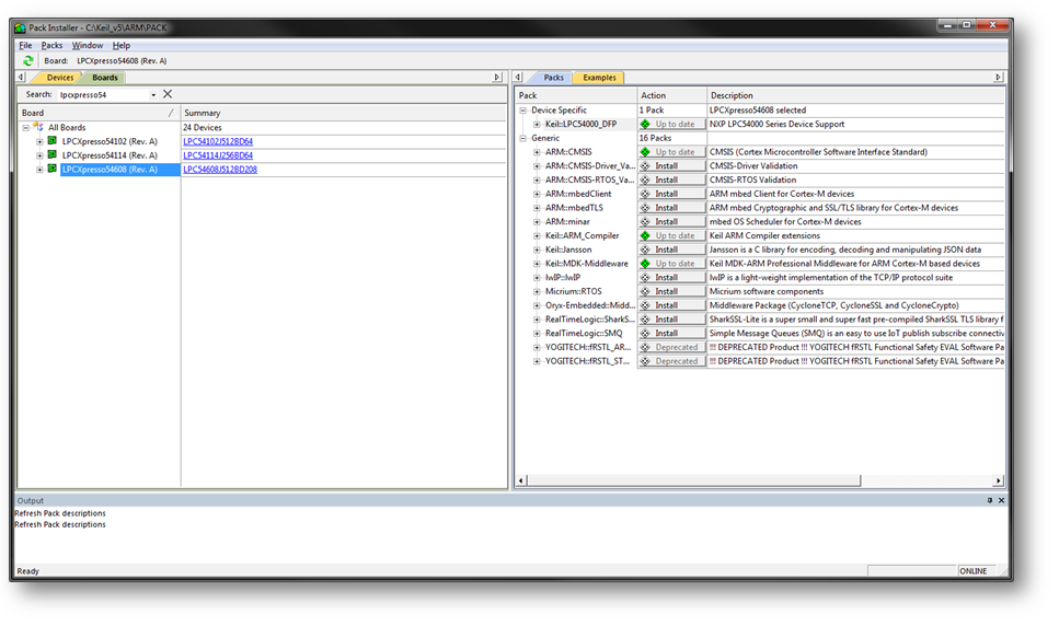

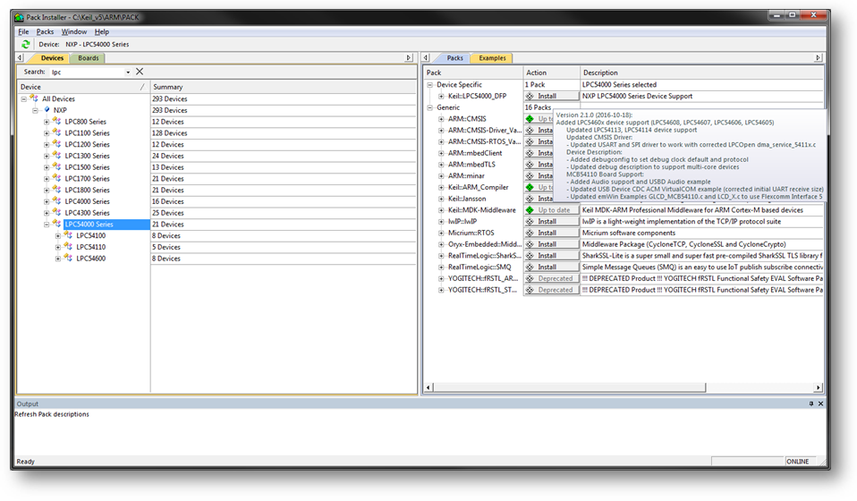

On the left hand side you see a variety of different manufacturers. The easiest way to search will be to type 'lpc' into the search right below the devices tab. Then select 'LPC54000 Series'.
On the right hand side under the packs tab you will see one item listed under 'Device Specific' called 'Keil::LPC54000_DFP' click on install
Note: Version 2.1.0 released on 10-18-2016 added LPC5460x support. If you had downloaded this pack before go to Packs>Check for Updates at the top to download the latest version
Once installed the diamond will turn green. To double check we are ready, select boards on the left side and search  'lpcxpresso54'. You will notice that our board is green indicating we have support for it in uVision.

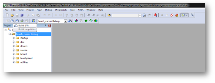

Select File>Open and navigate to the location you unzipped your SDK download.  By the way, within this folder there are plenty of SDK based demos for you to explore our microcontroller.  We will use one of them to guide you through this tutorial, but definitely take time to try all of them!
Navigate to boards>lpcxpresso54608>demo_apps>touch_cursor>mdk, change file type to ''Project Files (*.uvproj, *.uvprojx) and select 'touch_cursor'

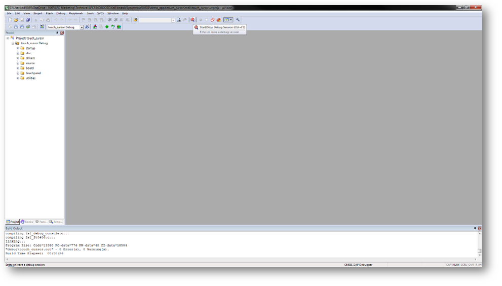

Once opened, select 'Build' right above the Project window.
Once the Build Output window tells you that you have successfully built the program select the 'Start/Stop Debug Session' icon.
Note: You may receive a warning if you have a size limitation on the license you are using. If you do get a warning you can resolve licensing issues by going to File>License Management.

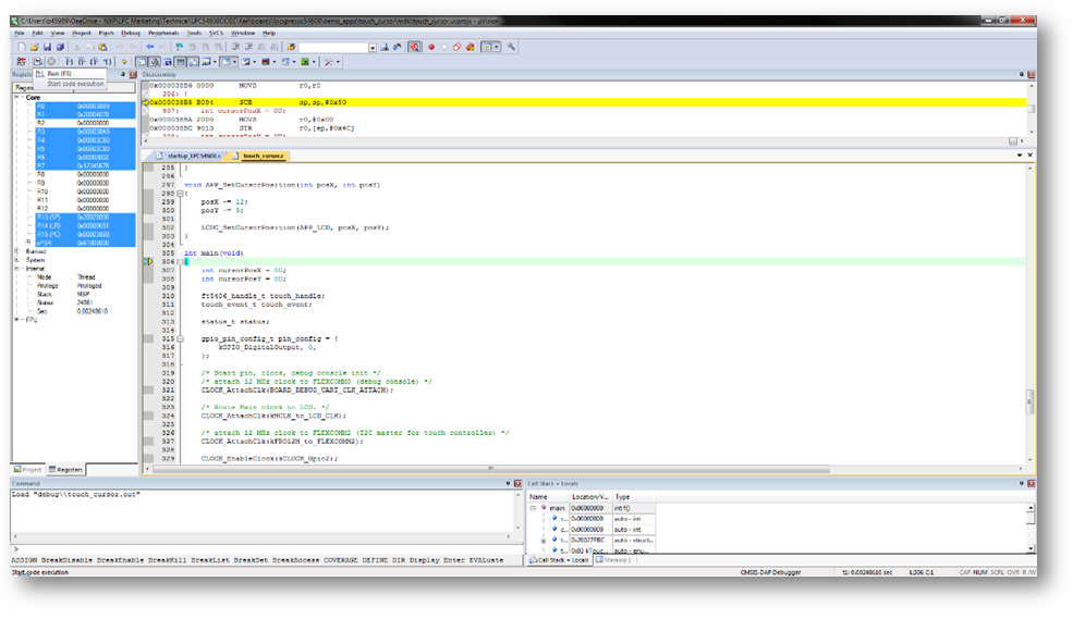

Once the debug session has been started select 'Run' on the left side

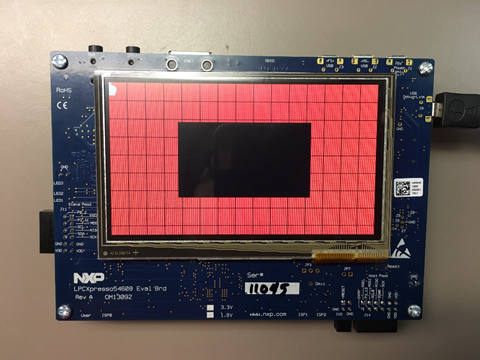

Once you have successfully flashed the board with this demo you will see the following,
This demo utilizes the touch interface on the screen to read where you are touching and updates the cursor position to the last known location.
