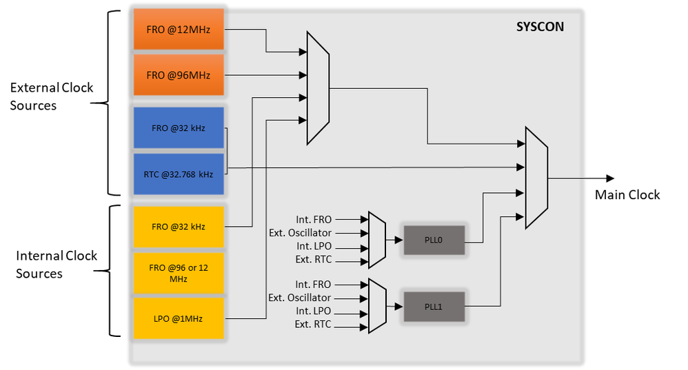

The following diagram shows a high-level description of the possible internal and external clock sources, the interaction with the SYSCON block, and the PLL modules.
javier_chavezq_12-1599155716496.png Figure 1. General SYSCON diagram

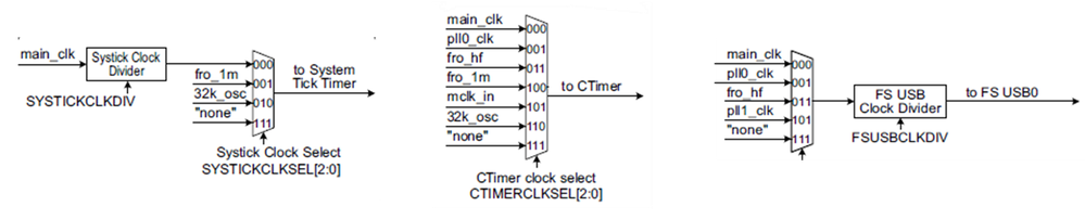

Also, the SYSCON module has several clock multiplexors for each peripheral of the board i.e(Systick, FullSpeed-USB, CTimer), so each peripheral can select its source clock regardless of the clock source selection of other peripherals. For example, the following figure shows these described multiplexers and all the possible clock sources that can be used at the specific module.
javier_chavezq_13-1599155716777.png Figure 2. Source clock selection for peripherals

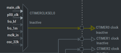

  • No Clock(Inactive)
Figure 5. CTimer0 Clock Source Selector
Select CTIMERCLKSEL0 multiplexor and then switch to one of the mentioned clock sources, for example, the main_clk(Main Clock @150MHz) the clock multiplexor gets active and the yellow path is highlighted as shown in the following image.
javier_chavezq_17-1599155716877.png Figure 6. CTimer0, Main Clock attached
