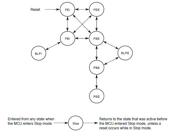

It’s important to know that the MCG has 9 states of operation shown in the following figure.
 Figure 3. MCG operation states
In the previous image, the arrows indicate the permitted MCG state transitions, for example, if the current MCG state is BLPI(Bypassed Low Power Internal) and the desired state is BLPE(Bypassed Low Power External) the shortest and allowed path to follow is first switch to FBI(FLL Bypassed Internal) then to FBE(FLL Bypassed External), and finally to the BLPE MCG state. These switching mode restrictions exist due to certain MCG configuration bits that must be changed to properly move from one mode to another.

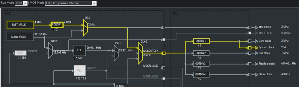

The FBI state allows us to use the Fast IRC together with its frequency divider achieving frequencies between 31.25KHz to 4MHz, for this example the final core clock is @2MHz. Follow the next steps to change to the FBI state and select a 2MHz clock using the Clock-Tools tool from MCUXpresso IDE.

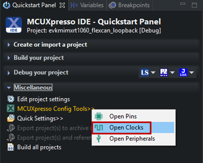

  1.        At the MCUXpresso QuickStart Panel select MCUXpresso Config Tools >> Open Clocks
javier_chavezq_4-1599155713991.pngFigure 5. Open Config Tools
  1.        At the left top of the screen select the MCG mode to “FBI(FLL Bypassed Internal)”
javier_chavezq_5-1599155714080.pngFigure 6. Selection of MCG Mode
  1.        Select the frequency divider block(FCRDIV) right-click on it and select “Edit settings of: FCRDIV”
javier_chavezq_6-1599155714206.pngFigure 7. FCRDIV block
  1.        Modify the divider value from 1 to 2.
javier_chavezq_7-1599155714287.pngFigure 8. FCRDIV divider value
  1.        Finally, the next image shows how the MCG state and the new yellow paths get modified. The Core and system clocks are @2MHz.
javier_chavezq_8-1599155714633.pngFigure 9. FBI MCG state @2MHz

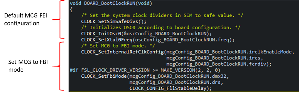

1.2 Export clock configuration to the project
After you complete the clock configuration, the Clock Tool will update the source code in clock_config.c and clock_config.h, including all the clock functional groups that we created with the tool. In the previous example, we configured the MCG state to FBI mode, this is translated to the following instructions in source code: “CLOCK_SetInternalRefClkConfig();” and “CLOCK_SetFbiMode();”
javier_chavezq_9-1599155715228.png Figure 10. Source code view of FBI MCG configuration

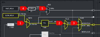

Another way to change the MCG state is by directly modifying the internal MCG registers. The blocks shown in the following image need to be modified to switch from the default FEI state to the FBI state.javier_chavezq_10-1599155715513.pngFigure 11. Blocks in FEI state to modify at MCG registers
Note. MCG registers can only be written in supervisor mode. The ARM core runs in privileged(supervisor mode) out of reset, it is controlled by [nPRIV] bit in CONTROL core register. For more detailed information visit the Cortex-M4 ARM Documentation Reference Manual.
  1.        Internal Reference Source Multiplexor (IREFS), selects the reference source clock for the FLL.
  •  1 is written to C1[IREFS].
    • The slow internal reference is selected.
  1.        PLL Select  Multiplexor(PLLS) Controls whether the PLL or FLL output is selected.
  • 0 is written to C6[PLLS]
    • The FLL output is selected as the MCG source, the PLL is disabled.
  1.        Clock Source Select Multiplexor(CLKS), selects the clock source for the MCGOUTCLK  line.
  • 01 is written to C1[CLKS].
    •  The internal reference clock is selected at the CLKS multiplexor.
  1.        Fast Clock Internal Reference Divider(FCRDIV), selects the Fast Internal Reference Clock divider, the resulting frequency can be in the range of 31.25KHz to 4MHz.
  • 001 is written to SC[FCRDIV].
    • The dividing factor is 2 since the desired frequency is @2MHz and the source clock is @4MHz.
  1.        Internal Reference Clock Select (IRCS). Selects between the fast or slow internal reference clock source.
  •  x is written to C2[IRCS].
    • Write 0 for Slow IRC or 1 for Fast IRC.
  1.        Finally, to enable the low power when neither the PLL nor FLL are used, a register in C2[LP] is modified.
  • x is written to C2[LP].
    • Enable, or Disable the PLL & FLL in all the bypass modes.

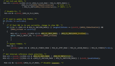

This is translated to the following instructions in source code in “CLOCK_SetInternalRefClkConfig();” and “CLOCK_SetFbiMode();” functions:
javier_chavezq_11-1599155716412.png Figure 12. Source code view of Internal MCG Registers
Note. C1, C2, C6, and SC registers are part of the internal MCG control registers.
