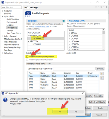

Right click “MCU” under Project tree, choose “Edit MCU”
Uncheck ”Preserve memory configuration”(it is checked by default)->choose LPC55S06->there is a warning, choose Yes.
We can see the Memory details changed to lpc55s06, then click ”Apply and close”.

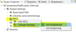

1.2 – Change Package

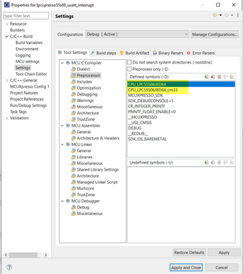

2 - Change Compiler Definitions
In Properties view->Settings->MCU Compiler ->Preprocessor, change the definition for CPU from LPC55S69JBD100 to LPC55S06JBD64 as below:

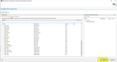

3 – Change/add SDK driver for LPC55s06

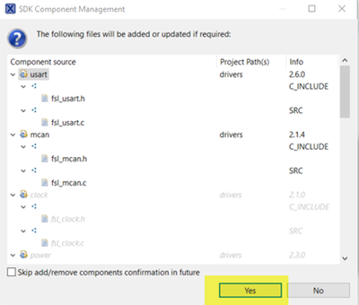

Selected project, then click ”Manage SDK components”, choose the drivers our application used, for example, clock, power, usart.
Click “OK”, then click “Yes” to update.

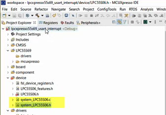

Delete LPC55S69 device related files:
Add “system_LPC55S06.c” and “system_LPC55S06.h” files:
