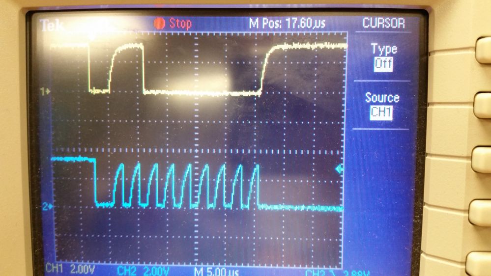

The issue I'm experiencing is that it appears the i2c master interrupt handler is not getting called when using I2C_DRV_MasterSendDataBlocking(). This is what I know:
  1. Master sends a start condition successfully (Oscope)
  2. Master sends the slave device address successfully (Oscope)
  3. Slave ACKs the device address successfully (Oscope)
  4. This is where the transaction stops and the driver returns kStatus_I2C_Timeout every time
(Above is my Oscope readout confirming the device address of 0xC0 is sent and ACK'd by slave)

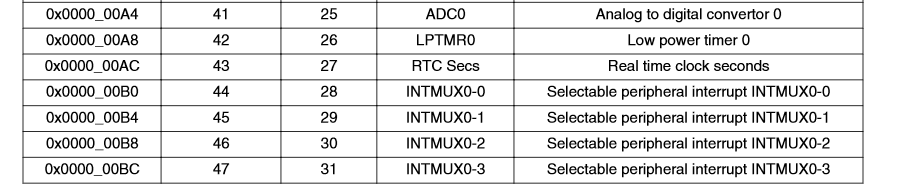

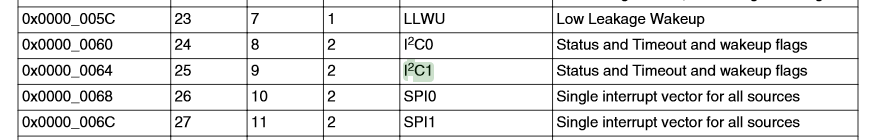

The interrupt mux is present on cortex-M0 devices where the number of interrupts in the system is larger than what the cortex-m0 can handle (32 individual interrupt channels). The I2C1 interrupt is not assigned to one of the 32 core interrupts, but instead is placed on the intmux peripheral. You can see this assignment from the KL82 reference manual, section 3.2.5.
In order to route the interrupt from the I2C1, you must route it through one of the cortex-m NVIC vectors assigned to INTMUX-0. You can see the choices below.
The code that Susan has provided above will enable the INTMUX clock, choose the I2C1 interrupt on the INTMUX, and then finally enable the INTMUX interrupt.
The reason you don't see this special step on the KL27 is assigned to the NVIC controller, table 3-2 in the KL27 reference manual.
I hope this helps you get your I2C1 solution working on the KL82!
