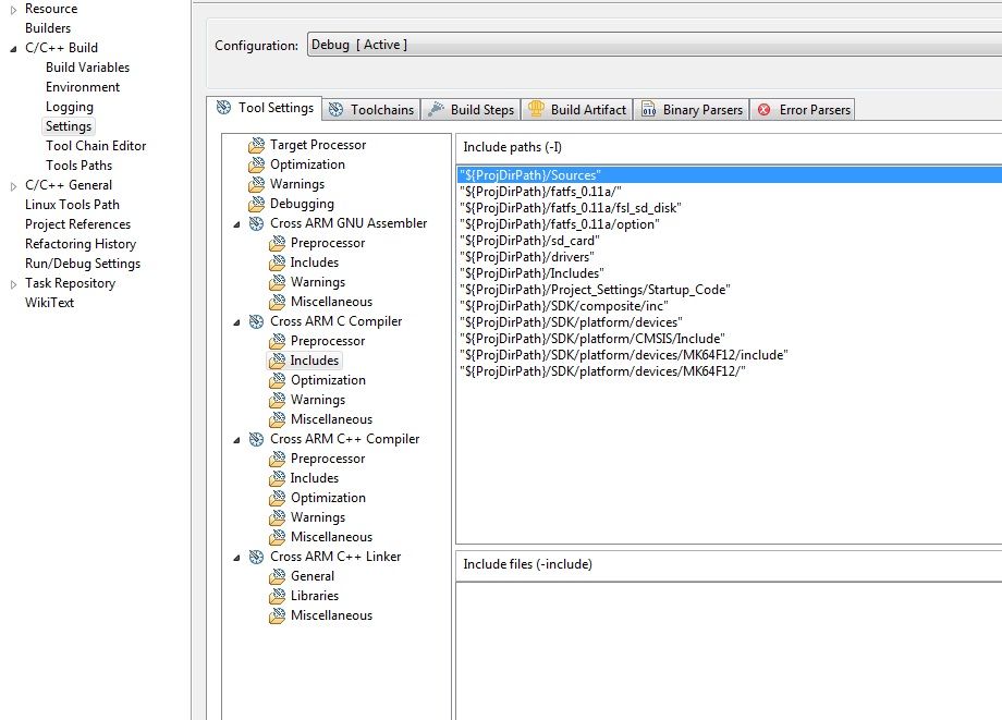

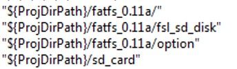

Hi everyone,
I updated my KDS, KSDK  and fatfs0.11a
I wanted to change from fatfs R0.09 to R0.11a.
I have updated my paths and my build variable.  Here is what I did:
Build variable:
C:\Freescale\SDK_2.0_K64F
Cross ARM C Compiler->Includes:
"${ProjDirPath}/fatfs_0.11a"
"${ProjDirPath}/fatfs_0.11a/fsl_sd_disk"
It seems I am missing something, because I still getting the following error after I compile:
If anyone has done the update and has run into this issue, please advice as to what could be happening?
thanks,
Neil Porven

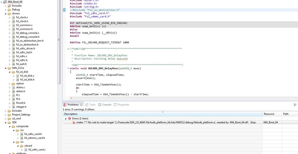

neilporven
Senior Contributor I
Hi Isaacavila,
I imported the sdmmc2.0.0 folder and added the PATH for it and I am now showing an error inside the sdmmc2.0.0??
Here is a picture:
Here is the path:
"${ProjDirPath}/sdmmc_2.0.0"
Here is the console error:
DescriptionResourcePathLocationType
fatal error: fsl_card.h: No such file or directoryfsl_mmc.c/K64_Boot_04/sdmmc_2.0.0/srcline 32C/C++ Problem
make: *** [sdmmc_2.0.0/src/fsl_mmc.o] Error 1K64_Boot_04C/C++ Problem
It looks like if its having an issue with fsl_card.h, not sure if maybe I need to include another folder?
Have you seen this issue before or from looking at this know what is happening?

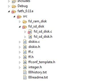

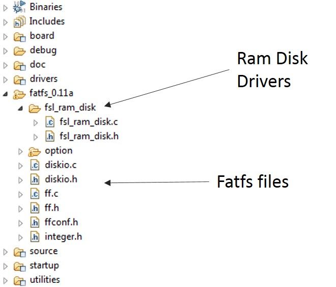

isaacavila
Hello Neil,
If you look at {KSDK_2_0_PATH}\middleware\fatfs_0.11a\src you will find a 00readme.txt file in which, there is a note at the end:
"Low level disk I/O module is not included in this archive because the FatFs module is only a generic file system layer and not depend on any specific storage device. You have to provide a low level disk I/O module that written to control the target storage device."
This way, fatfs middleware has folders for different storage devices like mmc, ram disk, sd disk, etc. You only need to add the storage device you want to use and also, you will need to add their drivers. For example, if you will be using ram_disk, your structure should be like this:
And, you will need to include next paths:
Also, notice that you will need to change the ffconf_template.h file for ffconf.h, due ffconf_template.h is only a template for current fatfs configuration. Inside this ffconf.h file, there is a definition for different storage devices:

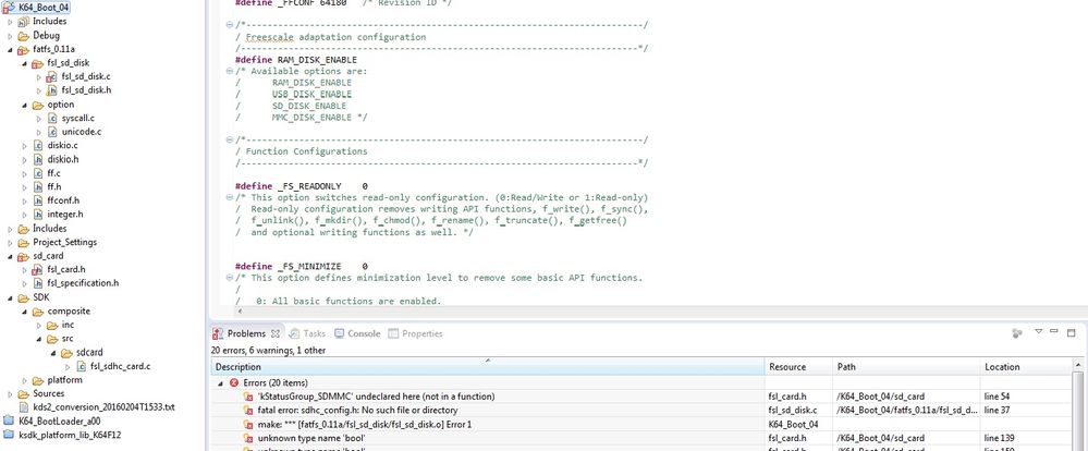

neilporven
Hi isaacavila,
I tried what you suggested, but I am still getting errors:
here are the paths:
"${ProjDirPath}/fatfs_0.11a/option"
"${ProjDirPath}/sd_card"
As you can see, there's something either I am not understanding or including, but if everything had stayed
as before, I would have expected some changes on 0.11a, but there are more changes here than expected?
4,016 Views
isaacavila
Hello Neil,
You need to include the sdhc_config.h file (just as it is shown on my previous post) and this file is located at: <KSDK_2_0_PATH>\boards\frdmk64f\driver_examples\sdcard_fatfs.
I have already tested and it should compile correctly after these files are included.
And indeed, it seems that this middleware has changed its structure and you will need to add some specific files that were not needed on previous releases. I will recommend you to use this stack for this KSDK 2.0 version instead of KSDK 1.3, otherwise, you will have to adapt this middleware to previous structure (because for KSDK 2.0, drivers have changed).
I hope this can help you!
Isaac

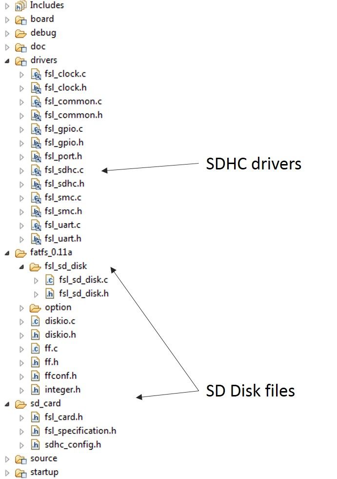

neilporven
Hi isaacavila,
Where can I find the SDHC drivers (fsl_sdhc.c/fsl_sdhc.h)?  Also, I noticed that it is stored in a file called drivers, but
on the path you suggested, it doesn't seem to address it?  Where should I place them and where do I need to call them
from?
Neil
4,016 Views
neilporven
Update,
I found SDHC drivers, they are located <KSDK_2_0_PATH>\devices\MK64F12\drivers. I created a folder as shown above,
but the path needs to be created or a way that lets the IDE know it exist and how to use them?
Thank,
Neil

this way, you will AVOID to included paths from different versions (SDK 1.3 and SDK 2.0) and drivers
Does ti make sense to you?
Isaac
