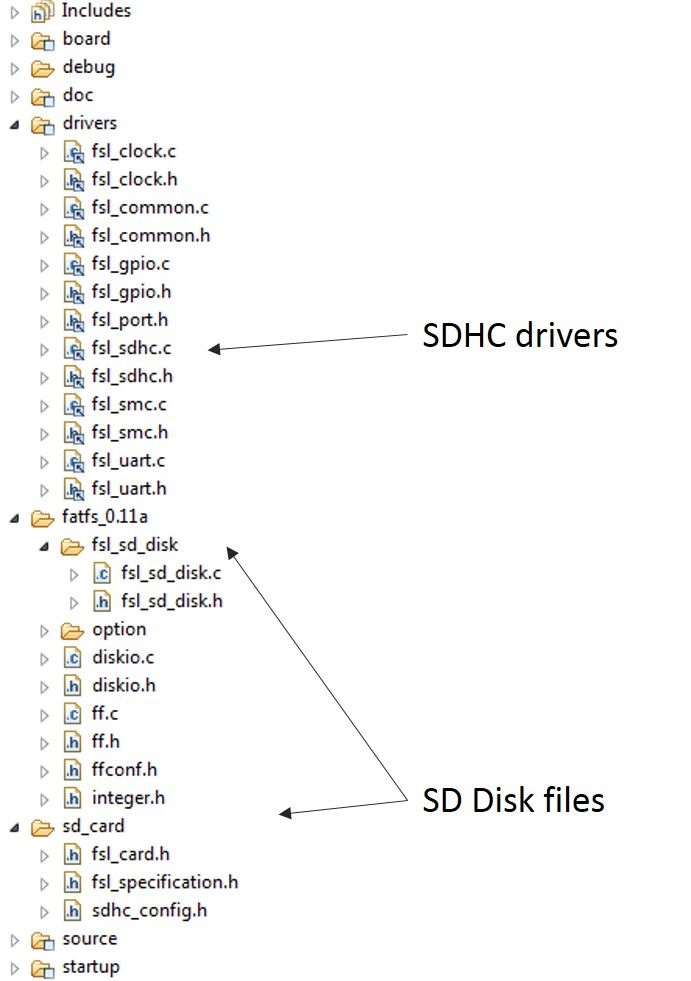

neilporven
Senior Contributor I
Update,
I found SDHC drivers, they are located <KSDK_2_0_PATH>\devices\MK64F12\drivers. I created a folder as shown above,
but the path needs to be created or a way that lets the IDE know it exist and how to use them?
Thank,
Neil

isaacavila
Hello Neil,
This file is located in same driver folder (<KSDK_2_0_PATH_K64>\devices\MK64F12\drivers), please check the images where I showed all the files that are needed (and compare with yours) in order to avoid compilation errors.
Isaac

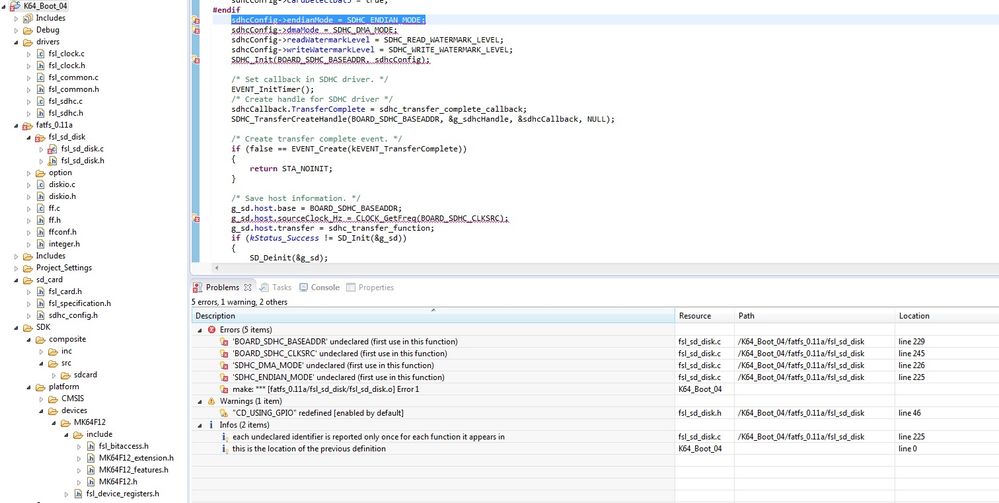

neilporven
Quick update,
I found the issues with line 225 & 226, I had commented those defines, prior, trying to isolate other issues!
I simply wend ahead and remove the comments and those issues are gone. Now I still have the following:
DescriptionResourcePathLocationType
'BOARD_SDHC_BASEADDR' undeclared (first use in this function)fsl_sd_disk.c/K64_Boot_04/fatfs_0.11a/fsl_sd_diskline 229C/C++ Problem
'BOARD_SDHC_CLKSRC' undeclared (first use in this function)fsl_sd_disk.c/K64_Boot_04/fatfs_0.11a/fsl_sd_diskline 245C/C++ Problem
I thought I might have done the same thing, but that is not the case or at least I did a global search and I can't find them?
Neil

isaacavila
Hello Neil,
SDHC definitions that are missing should be declared in sdhc_config.h file (I can see that you are already including it and also you will need the fsl_sdhc.h file from SDK 2.0). Other definitions (BOARD_SDHC_BASEADDR and BOARD_SDHC_CLKSRC) are defined in board.h file from any SDK 2.0 example, so make sure these files are included and these macros are also defined there.
For this new SDK 2.0 some drivers have changed and structure is not the same as 1.3, that is why you are facing some problem on migrating fatfs 0.11a to SDK 1.3. Try to add these definition in and see if error are still presented, if so, you will need to migrate fatfs 0.11a version to KSDK 1.3 version manually.
Isaac
