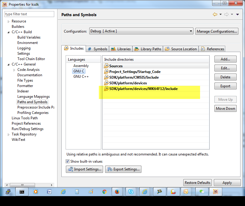

Hi Neil.
the latest KDS version is v3.0, but the latest KSDK version is v2.0.
regarding your project didn't find MK64F12.h, please check if the related path included. for example, with KDS, the path setting is as below.
can this help you?

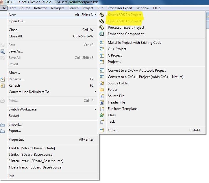

Hi ZhangJennie,
I have KDS 3.1.0 and I did a KSDK build particularly for the K64F processor (SDK_2.0_K64F).  Here is a screen
shot of what I see, when I try to start a new project.
Strangely enough, if I choose Kinetis SDK 2.x Project, it doesn't place a SDK file?
Did I downloaded something wrong, thinking it was the latest KDS and instead, I got
something else or is the KDS correct and now the SDK file is no longer needed because
it is being linked outside the IDE through paths?

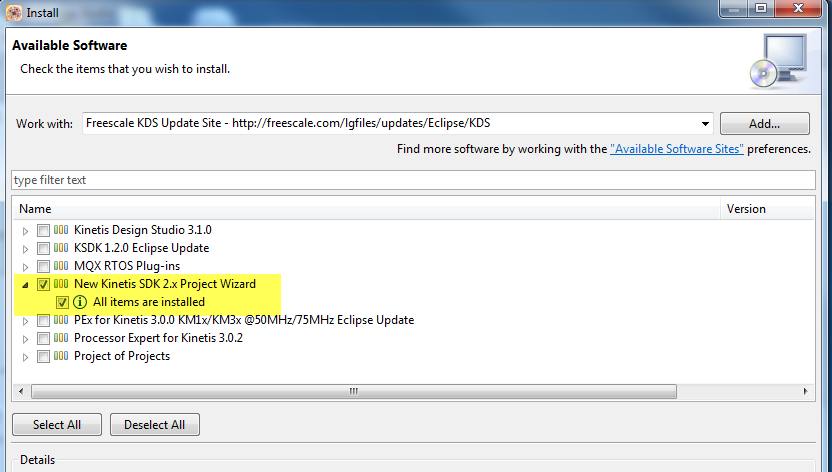

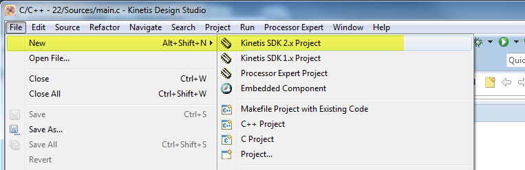

ZhangJennie
Hi Neil.
please make sure you have "New Kinetis sdk 2.x project wizard" installed to kds3.0
after the install, you will be able to see it in the menu:
can this help you?
Jennie Zhang
3,043 Views
neilporven
Senior Contributor I
Hi ZhangJennie,
Thank you.  Yes, I had already installed the sdk 2.x and have viewed the video.

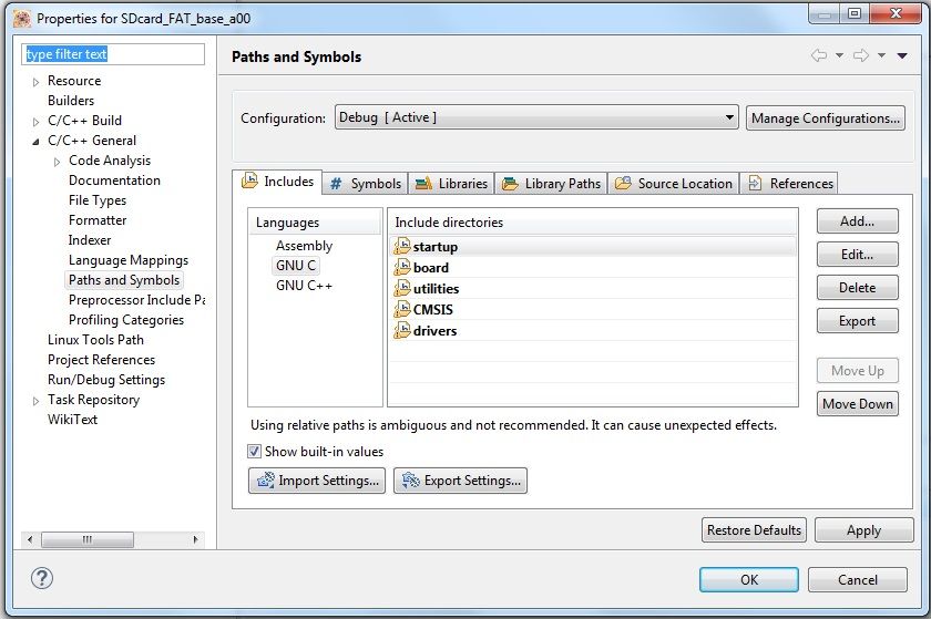

In Addition,
Here is a screenshot of my Path and Symbols, once a new project is created:
and here is what I see, when a new project is created:
Not sure what to do at this point, but if I import previous working/compiling projects they start complaining about define
in the MK64F12.h file.
3,044 Views

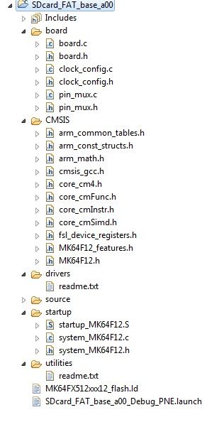

neilporven
Update,
It appears that the new file structure doesn't contain an include file/folder and importing
it from my previous project doesn't seem to work (meaning fails to recognize the MK64F12.h).
If instead I import to the CMSIS file/folder, then some of the defines are seen.
Curiosly enough, looking at the previous project, SDK 3.0, MK64F12.h appears in two areas, inside
the CMSIS and in the startup file/folder. Another observation is that the two MK64F12.h are different
and have different builds.
Yet another interesting issue is that the way I addressed the registers under SDK 3.0 is now not
recognized by 3.1.0?   Example 3.0: UART0_PRC15 = some HEX value
                                     Example 3.1: UART0->PRC[15] = some HEX value
