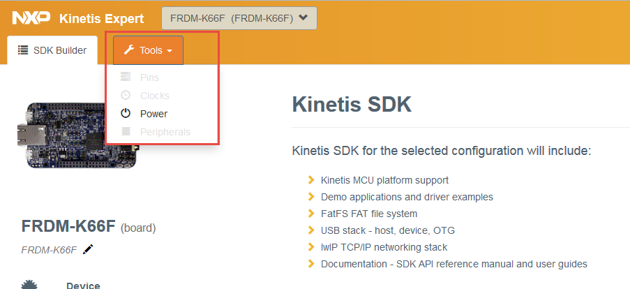

2,4) At the moment I have finished my testing - load demo application Hello World from SDK 1.3 for FRDM-K64 under KDS 3.2 ,execute it and it works without problems
At the moment there is no support for KV58F in KSDK. (neither KSDK 1.0. nor KSDK 1.3) But KV58F could be supported in KSDK 2.0 in July. Also you can test new tools replacing PEx capability called Pin Tool, Clock Tool, which will be also ready soon.
For this while is available Power Estimation Tool. (please see picture below)

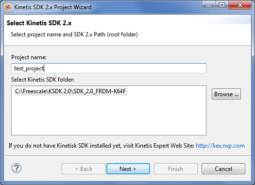

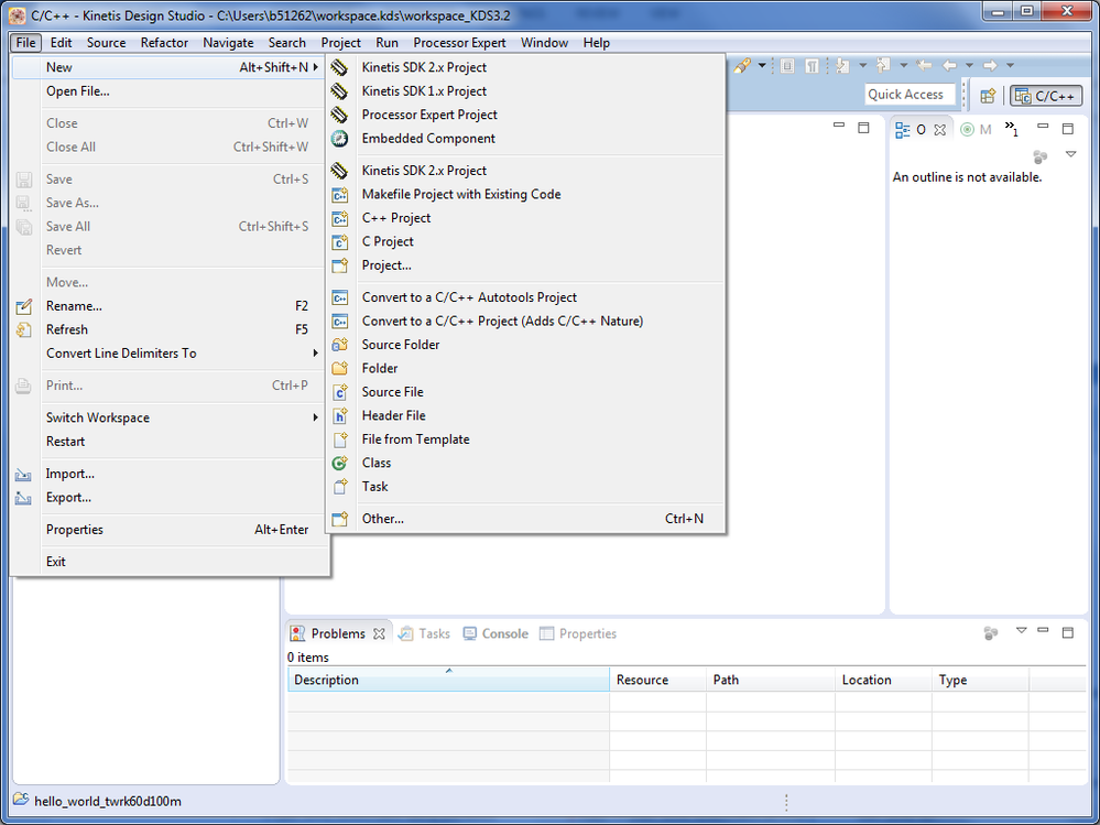

Project wizard looks :
You can easily create new project by this wizard
or  you  can import the demo project by right click in Project Explorer Window and select Import .

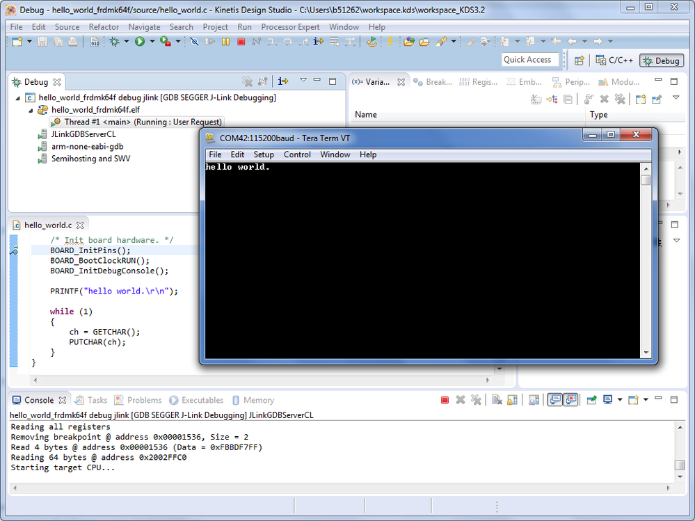

After that I am able to flash the demo.
2. No, there is no reason.
3. Please see attached file with FRDM-K64 (the procedure is the same)

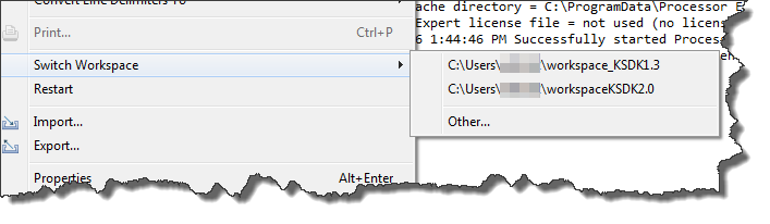

Yes, you can have installed all versions KSDK, but it is recommended to use different workspace. Create for each version KSDK own workspace in KDS. (KSDK 1.2 will use workspace1.2, KSDK 2.0 workspace2.0 etc..) and you will switch between these workspaces.
