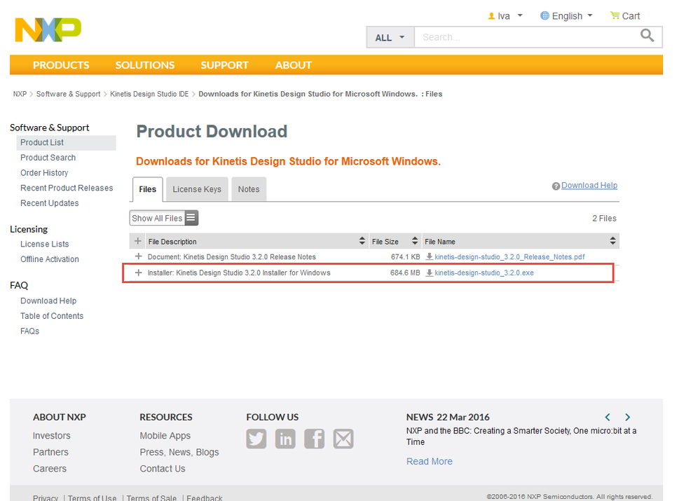

ivadorazinova
Hi Christie.
1. Not sure, what do you exactly mean.
Please, did you correctly install KDS 3.2? https://nxp.flexnetoperations.com/control/frse/download?agree=Accept&element=7490587
Project wizard looks :
You can easily create new project by this wizard
or  you  can import the demo project by right click in Project Explorer Window and select Import .
After that I am able to flash the demo.
2. No, there is no reason.
3. Please see attached file with FRDM-K64 (the procedure is the same)
4. Right. The PE is not available for KSDK 2.0 but you can forward to new tools which coming soon.
5. My response in 3) point
6. For supported devices in future please see updated list at Introducing Kinetis SDK v2
KV58F could be supported in Release 3 – Target: Mid July, 2016
Kinetis V device and evaluation hardware support
But if you don´t want to wait, you can use any of paid IDE, as
IAR IAR Systems
KEIL Keil Embedded Development Tools for ARM, Cortex-M, Cortex-R4, 8051, C166, and 251 processor families...
Atollic ARM Development Tools IDE | TrueStudio from Atollic
or GCC.
In case of any issue or if I forget anything, please let me know.
Iva
