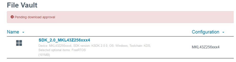

same here! Moreover I even cant download it:   "Pending download approval" the message i got.
PEx+KSDK were the things made me migrate to Kinetis.
To get the Old KSDK 1.3 FULL I need to download around 300mb and need no any approval. Now for only 1 part i need to dowanload 100mb and wait for some approval. What for?
Are there any public roadmap of the future? Why do we need discret ksdk download for each part? I got like 10 different Kinetis parts on my working place right now. Maybe there any plans to make a paid license to different ksdk? Will MQX die?

ivadorazinova
Hi Alexey and adyr!
now you should download KSDK without problems - please check it and let me know.
Here is whole procedure, please check the steps if you are not wrong:
How to: install KSDK 2.0
Using Kinetis Design Studio V3.x with Kinetis SDK V2.0
The decision for downloading each package separately is because of the size.
You don´t need to download whole KSDK package for all boards.
MQX will not be supported by KSDK and PEx will be replaced by another tool.
