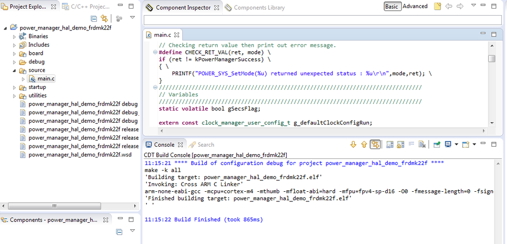

Hello Michael,
There is no low_power_demo_frdmk22f demo under KSDK1.3 , where is it ?
There is only have " power_manager_hal_demo ', the path is :
KSDK_1.3.0\examples\frdmk22f\demo_apps\power_manager_hal_demo
And after i build it on KDS 3.0 , there is no erro :
