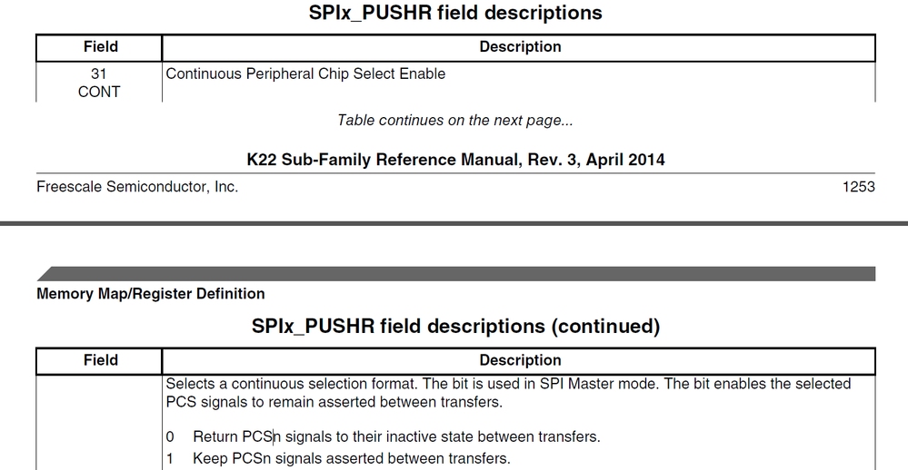

Hello Thanh,
For the Kinetis L series, it have not the function of "Keep PCSn signals asserted between transfers.".
While for the Kinetis K series,  the SPI IP is DSPI, we can use the register of  SPI_PUSHR->CONT to configure
this function :
Hope it helps
Alice

xiangjunrong
Hi, Thanh,
The SPI module of Kl25 uses different SPI IP from that of Kinetis K family, the SPI of KL25 does not have the CONT bit in it's registers, but the SPI module of K family has as Alice said. You set the SPI in master mode, generally, the /SS pin is driven by the SPI master module, when transferring data, the /SS pin is driven to low logic automatically so that the slave spi device can be selected. During the interval of data transfer, /SS pin is driven to high automatically, this is a normal operation.
If you want that  /SS pin  is always driven to low, as you know that /ss pin is multiplexed with GPIO function, you can configure the /SS pin in GPIO mode, before transferring data, you can clear the /ss pin, then you can transfer the data one by one, after all data have been transferred, set the /ss pin, it is okay.
Hope it can help you.
Xiangjun Rong
