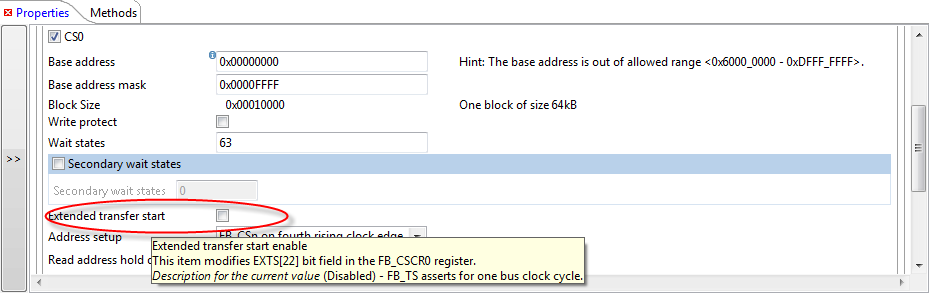

I am trying to setup Flexbus using processor expert and I the ALE size is multiple clocks.
the device I am using is mk20fx512vmd12
and I am using Kinetis Design Studio Version: 2.0.0 Eclipse Version: Kepler (4.3.2)
Here is my flexbus init from cpu.c

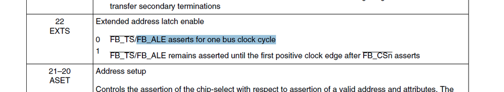

Kan_Li
Hi Zohar golan,
I noticed you set EXTS=1, so that might be the root cause, you have to set it as zero to let FB_ALE just asserts for one bus clock cycle, please refer to the following for details.
Hope that helps,
Kan
