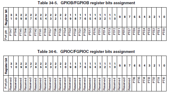

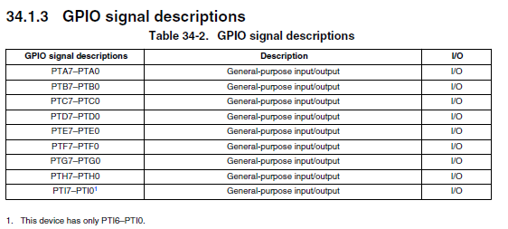

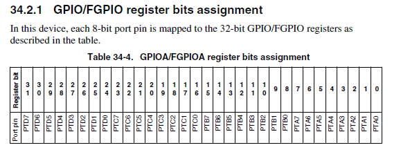

Dear 文星 马,
I´m not sure what you exactly mean.
GPIO signal Descriptions is described in following table, page 678
If you mean GPIO/FGPIO register bits assignment, please go to Reference Manual for KE06, page 679
http://cache.freescale.com/files/microcontrollers/doc/ref_manual/MKE06P80M48SF0RM.pdf?fasp=1
I hope the information help you,
Iva
