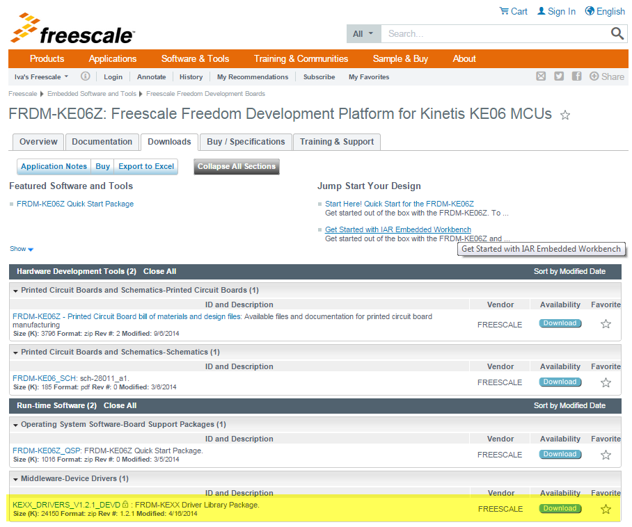

You can  also invite drivers and examples (for gpio), which can help you.
Freescale Freedom Development Platform for Ki|Freescale
