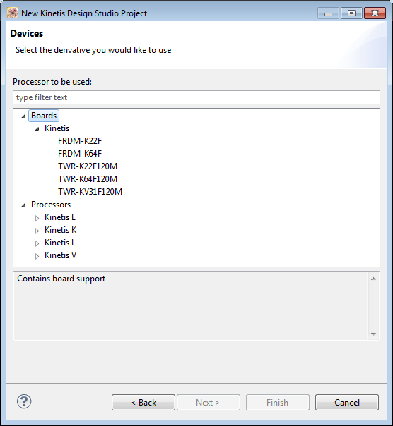

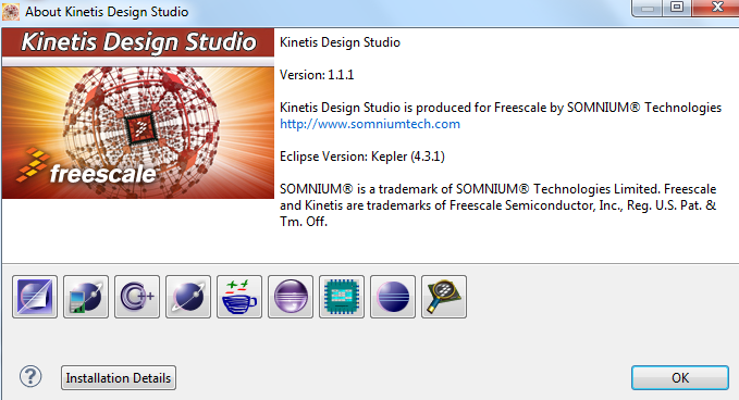

Hi Alice,
yes, Kinetis Design Studio v1.1.1 lists and supports TWR-K22F120M, below:boards with sdk.png

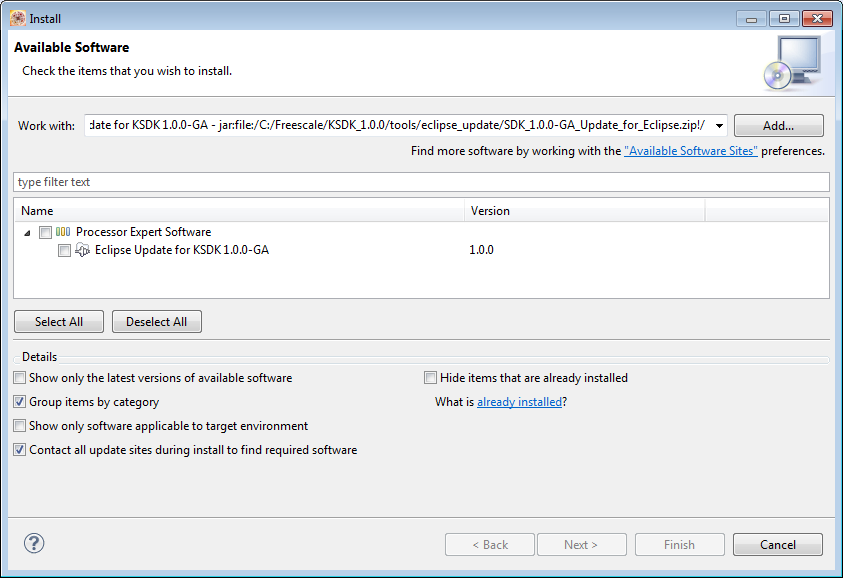

Note that these extra device support comes with the Kinetis SDK: So you need to download and install the Kinetis SDK (http://www.freescale.com/ksdk), and then in Eclipse you need to install the update (Help > Install new software):

jqwang
why my computer doesn't show the TWR-K22F120M in Boards->Kinetis when create one new KDS project? i have installed KDS_1.1.1 and KSDK_1.1.0.

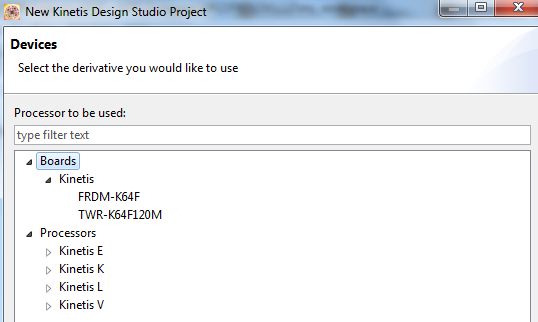

Hi JQ,
I think you have not installed the KSDK correctly .
Now ,you create project ,choose  FRDM-K64, then click NEXT,  check whether the  "Kinetis SDK " can choose ?
Please Show your screenshot like mine :
And please refer to the " Getting Started with Kinetis SDK (KSDK) .pdf(C:\Freescale\KSDK_1.1.0\doc)   ->  5.2 Install Eclipse update"
update your KSDK .
Best Regards
Alice

jqwang
Thank you. After I installed the “SDK_1.0.0-GA_Update_for_Eclipse_1.0.1.zip” downloaded from freescale website, then the issue was gone.

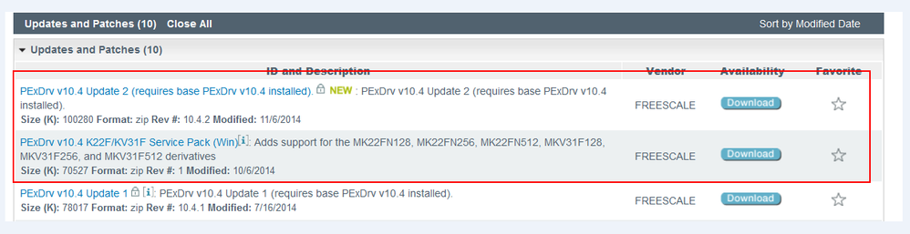

Hello Erich and lan ,
Oh,  I'm wrong,   I see that in the title of issue , there is a "TWR-k24",   in that time i thought Lan  asked the k24,  sorry!
And Erich is right ,  you  can use Kinetis SDK .
Or you also can you Processor Expert without SDK,  in this situation ,you need update a patch .download on "Processor Expert Software, Microcontroller Dr|Freescale"
Best Regards!
