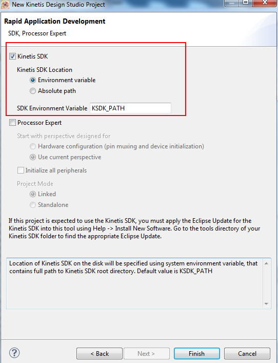

why my computer doesn't show the TWR-K22F120M in Boards->Kinetis when create one new KDS project? i have installed KDS_1.1.1 and KSDK_1.1.0.
4,412 Views
Hi JQ,
I think you have not installed the KSDK correctly .
Now ,you create project ,choose  FRDM-K64, then click NEXT,  check whether the  "Kinetis SDK " can choose ?
Please Show your screenshot like mine :
And please refer to the " Getting Started with Kinetis SDK (KSDK) .pdf(C:\Freescale\KSDK_1.1.0\doc)   ->  5.2 Install Eclipse update"
update your KSDK .
Best Regards
Alice
4,412 Views
jqwang
Thank you. After I installed the “SDK_1.0.0-GA_Update_for_Eclipse_1.0.1.zip” downloaded from freescale website, then the issue was gone.
