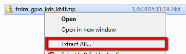

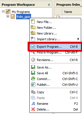

These are the steps I followed in order to migrate my project.

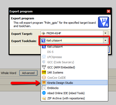

1. Right click on the mbed project and select Export Program
2. Click on the drop-down list and select Kinetis Design Studio. Then click on Export
3. A ZIP file will be downloaded. Extract this file to a known location.

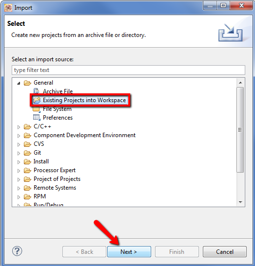

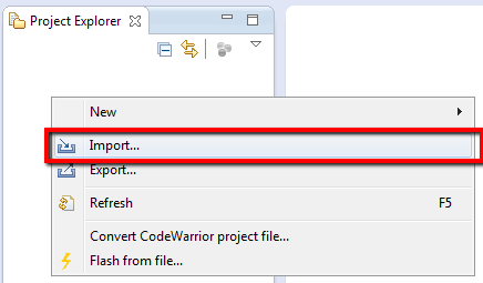

4. Open Kinetis Design Studio. On the Project Explorer region, right click and select import.
5. Select Existing Projects into Workspace and click Next

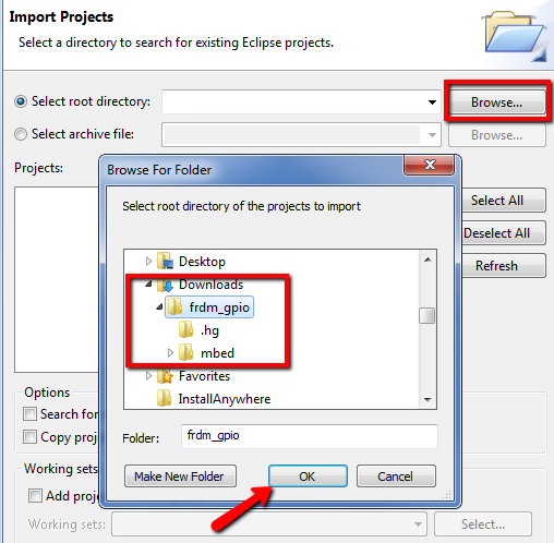

6. Click on Browse and select the location of the uncompressed folder

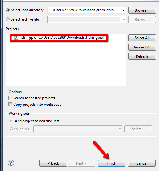

7. Make sure that your project is checked and click on Finish
After this your project should apear in the Project Explorer

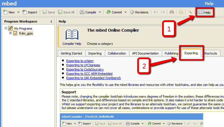

Hi Neil,
There is a tutorial explaining this on the mbed compiler help guide. Go to the compiler and click on the Help icon, then click on the Exporting tab. The last time I checked there was an option for exporting to Kinetis Design Studio.

Hi Santiago,
Disregard the previous message, its not in the help file, but its actually in the export feature.

Hi Santiago,
Unfortunately, I don't see an export feature for the Kinetis Design Studio.  I am very surprised sinceFreescale supports/partners with mbed?  Is there an alternate way of taking the .h and .c files and library includes to the Kinetis Design Studio?
