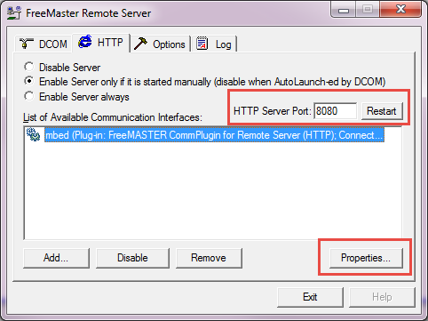

ivadorazinova
Hi Stefano.
If you want to set up Remote Server, please look at the example.
I hope it helps.

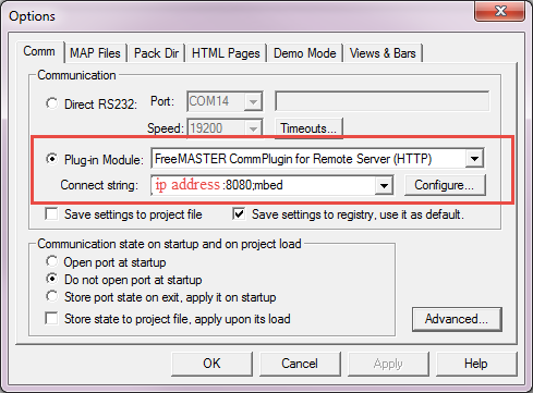

stefanomanca
Hi Iva, you say It can use only port 80 but why in http tab It can set the port number?I tryed to put 808 port number then from another PC I opened a broswer to http://myHost:808 and I got something correct but trying to connect from freemaster "client" I did not get anything.
ANYWAY, I tried by DCOM and it works but only from localhost.
Could you send me screenshot how to config permission by DCOMCNFG utility?
Thank you very much.
Stefano.

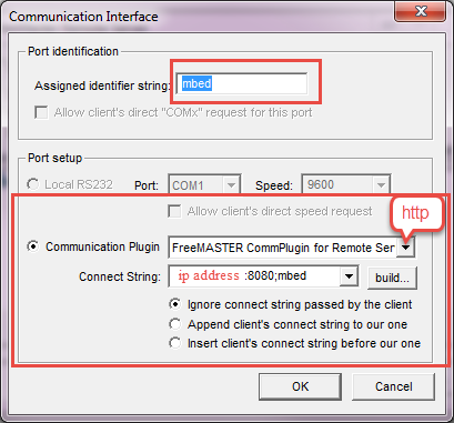

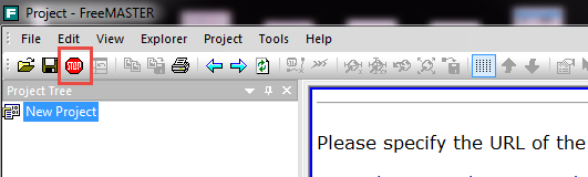

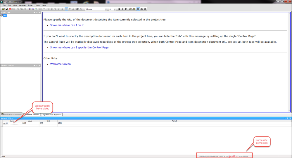

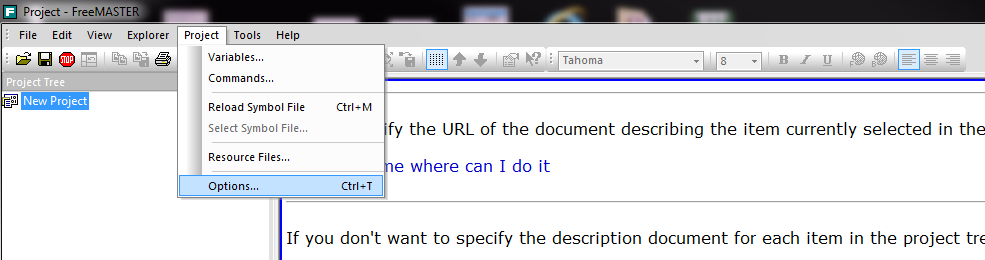

ivadorazinova
Hi Stefano.
  • First of all please check your Freemaster version. You may have the latest one 1.4.3 actually. You can download be this link FreeMASTER Run-Time Debugging Tool|Freescale
    • You need new version Remote Server app because of setting 8080 port
  • Secondly, I help you to set the http.
    • Please, go to FreeMaster Remote Server, tab HTTP
  • Thirdly go to Project > Options in Freemaster
  • After that click on Start Communication in Freemaster and you are successfully connected.
  • If you would like to set up DCOM, remember that must be login only 1 user on both computers
    • the process is the same like http, but you may choose DCOM in Remote Server and in Freemaster Options.
  • On the second computer,
    • you may to set up Remote Server Connection in FreeMaster Remote Server (Remote Server and Port Name) and add the Port setup. That´s it.

stefanomanca
Hi Iva, I got a partial result. Building a http link I forgot to put "Assigned identifier string" , I only put ip address:8080 but not mbed,....Ok now it works.....BUT..in your tutorial you choose "http" in "Communication Plugin" in Remote Server; actually it is wrong because in that filed I put a BDM Communication plugin because I have the physical  target attached.
Anyway, the DCOM connection does not work yet. Do you say it is necessary to specify a port number? Did you try using two different computer?  I get always "access denied".
Thank you anywhere you are ;-)
Ste.
12,684 Views
ivadorazinova
Hi Stefano. Yes, the tutorial shows type of connection RS232 so if you have BDM, you may to set BDM Communication. If you set the DCOM, it is specify without the port number, just ip address.
