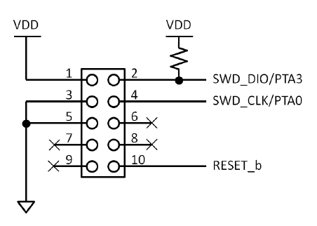

What's the minimum circuit requirement for KL/K mcu programming?

Hi, same problem on my board. I have a voltage of 1.5V on the reset pin with usbdm programmer. Tomorrow i will read the pin with an oscilloscope and try your solution. I have tried three different kl25 and all with the same problem.
16,210 Views
pgo
Senior Contributor V
Hi Daniele,
What USBDM programmer are you using?
bye
16,210 Views
danielecortella
Contributor V

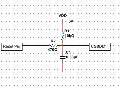

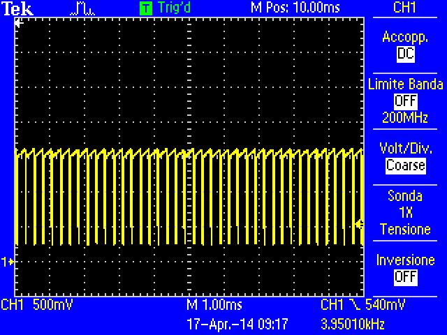

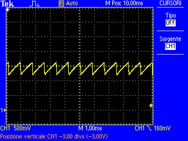

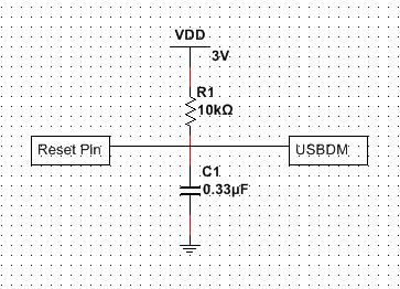

I'm using USBDM like here Using the Freedom Board as SWD Programmer | MCU on Eclipse. I have tried different solution but the problem still. F0001TEK.JPG.jpg
This is the signal that i read on the reset pin with this circuit
if i add this resistence of 470R
i see this signal on the reset pin
the problem is that the signal is only 1.5V, then i can't program the micro. I don't understand why the kl25 continue to reset ....
16,210 Views
pgo
Hi Daniele,
Does the programmer work OK with the on-board KL25 chip?
Also make sure you have programmed a dummy program to the on-board chip before using the external programmer. See at the bottom of this page:
USBDM: Setting Up the FRDM-KL25Z
The waveform you are seeing is to be expected from a blank chip.  The target device will be resetting itself due to either a watchdog timer expiration or due to executing an illegal instruction.  I've never bothered determining which.
This should not interfere with the programming.  I have confirmed this with a few different chips.
Does the stand-alone programmer detect the device at all?
Also selecting mass erase will usually be more reliable.
bye

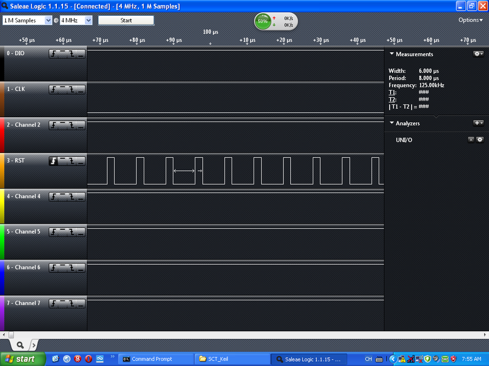

Now I found there is 125KHz signal comes from reset pin, check thread on https://community.freescale.com/message/384630#384630
Now I found it, but I have no idea how to solve it.

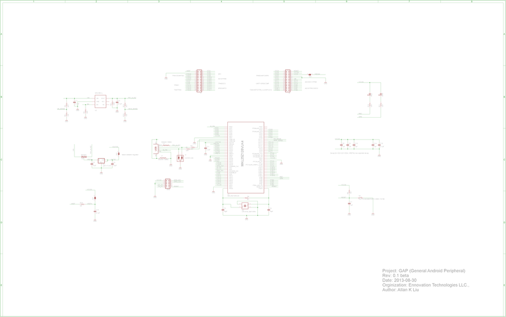

I tested again for programming my custom KL25Z boardwith OpenSDA of FRDM-KL25Z. Still fails on SWD communication error.
Debug Proble
I am not good at hardware debugging so I list my checklist here.
Cross checking with Cortex-M0+ mini board with LPC812 (NXP), success.
Cross checking with Cortex-M0+ mini board with LPC811 (NXP), success.
Cross checking with Crotex-M0 mini board with LPC1114F (NXP), success.
OpenSDA with KL25Z, fails (communication error).
Conclusion: board issues caused by KL25Z, OpenSDA works well.
Power supply
Check power supply, 3.3V regulated. (both from OpenSDA 3.3V pin headers as well as LDO from KL25Z board)
Check ground, done.
Decoupling caps, soldered. done.
Conclusion: Very good power supply with common ground.
Cables
Wire connection (RST/DIO/CLK), good, less than 10 Ohm (using IDC cable as well as other shorter wires as cross checking)
Power up measurement
VCC:3V, RST:3V, DIO:3V, CLK:3V (NXP board)
VCC:3V, RST:1.5V, DIO:0V, CLK:0V (KL25Z)
Reset Circuit?

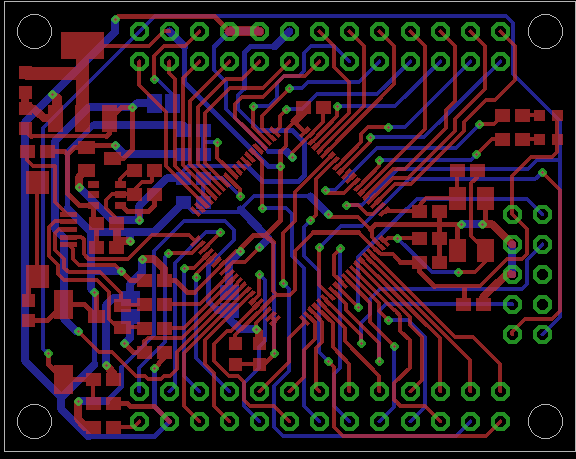

It seems RST is not stable or keep MCU in reset state. I checked my schematics & PCB layout.
Shematics (EAGLE)
The reset of SWD connects to MCU, and push button with 10K weak pull-up and 1uF to ground. (Although 1uF cap to GND looks big, but it is same as FRDM.)
In fact, I also tested (not fully tests) on a bare PCB with only SWD sockets and MCU on board. The reset connection from SWD to MCU is short enough, and 10K pull-up and 1uF to GND are empty. The reset should be fully under control of OpenSDA. Why this happens again?
In my last attempt programming with CoLinkEx, which use buffer IC to drive reset as well. It will reports "CAN NOT STOP MCU". Is there anything I should take care of reset?
PCB (EAGLE)
The PCB routing looks bad, it almost route three corners of the whole board. You can identify the right side SWD socket, the most right down corner is reset, then you can find the reset net links to reset pad, the other branch goes up, goes left most, before goes down to push button and 10K resistor and 1uF cap.
So far I can only find this "suspicious". Any comments are highly welcome.
Since it is my first FSL hardware platform, I will like to ask help from FSL experts.

pgo
Hi Kai,
The minimal circuit I posted above has been used OK with a FRDM-KL25 used as programmer board using USBDM.
I suggest you try this arrangement with USBDM as a sanity check i.e. a known working arrangement identical to your hardware.
The KL chips can be hard to reset "fresh" from the factory as they may be in a reset loop.  Still, most programmers should be able to cope with this.
As a side note.  You appear to be using pins 7 & 9 of the SWD connector for a serial port.  I suggest you not use pin 7 as it reserved for a key pin so (in theory) there will be some programming cables that will not be able to be physically connected to your board.
bye

A Kinetis chip with an invalid program may suffer from several kinds of program errors:
  • Failure to reset or disable the watchdog timer
  • Bus lockup on illegal program execution (illegal instruction or illegal address etc)
These will lead to the chip resetting itself.
This can be observed by  examining the reset pin with an oscilloscope.  It will be seen to be pulsing low by itself.
This can lead to problems since a reset may occur part way through the connection sequence.
bye

apanecatl
Senior Contributor II
The most basic circuitry you need is the power rail [VDD and VSS] connections, the decoupling capacitors for VDD, and pull-up resistors in the RST and SWD_DIO pins. By default the MCU starts up in FEI mode, thus; there is no need to use an external CLK source such as a XTAL. Also be very mindful of the cable connecting between your programming probe and the mcu; it must not be longer than 4 inches.
16,200 Views
kai_liu
Thanks Pedro,
I don't have pull up resistors on SWD_DIO as well as RESET. For my understanding, The pull-up is useful in JTAG debugger JTAG_TMS. The pull up resistor maybe drawn somewhere in reset circuit.
Anyway, I will try to check them all over again.
