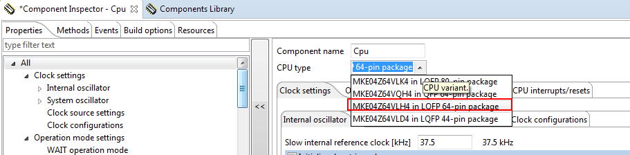

Hi Zachary,
Does your chip is MKE04Z64VLH4 ? If yes , please change the "CPU type":
then have a try , recommend you first send one char to the terminal , if still can not work,
please use the oscilloscope to check the TX pin whether have signal .
Hope it helps
Alice

Alice - thanks for your suggestions.  I downloaded and installed the KSDK1.3 and it does not seem to directly support the MKE04Z64VLH4 when using the New Project Wizard.  As for the FRMD_KE04 board itself, it never exhibits the problem.  The problem only occurs on my client's custom board, so I'm not sure you can reproduce the problem.  However I will try and send you the project in case you see something wrong.  My next step is to create a PE project (which does appear to support the MKE04Z64VLH4).  I will post an update when I have some more information.  Thanks for your help.
Zack
