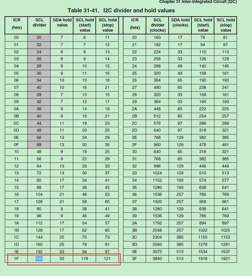

In the I2C driver the baud rate is kept as 0x1F ,what is the baud rate
that corresponds to?

Can you please tell me,what does this 0x1F refer to that is it
corresponds to what baud rate???In the I2C driver we are putting it as 0x1F.

kerryzhou
Hi Vignesh,
Could you tell me what the 0X1F from? Did you define the I2Cx_F=0x1f?
If yes, now I tell you how to calculate the baud rate.
I2C baud rate = I2C module clock speed (Hz)/(mul × SCL divider)
2C module clock speed is the bus clock.
mul=I2Cx_F[MULT]+1;
SCL divider, you need to check the Table 31-41. I2C divider and hold values in the KEA referece manual.
Now take I2Cx_F=0x1f as an example, it means, mul=1, SCL divider= 240.
Then, assume your bus clock=24Mhz,
I2C baud rate = 24Mhz/(1*240)=100Kbps.
More details, please read the referece manual carefully!
