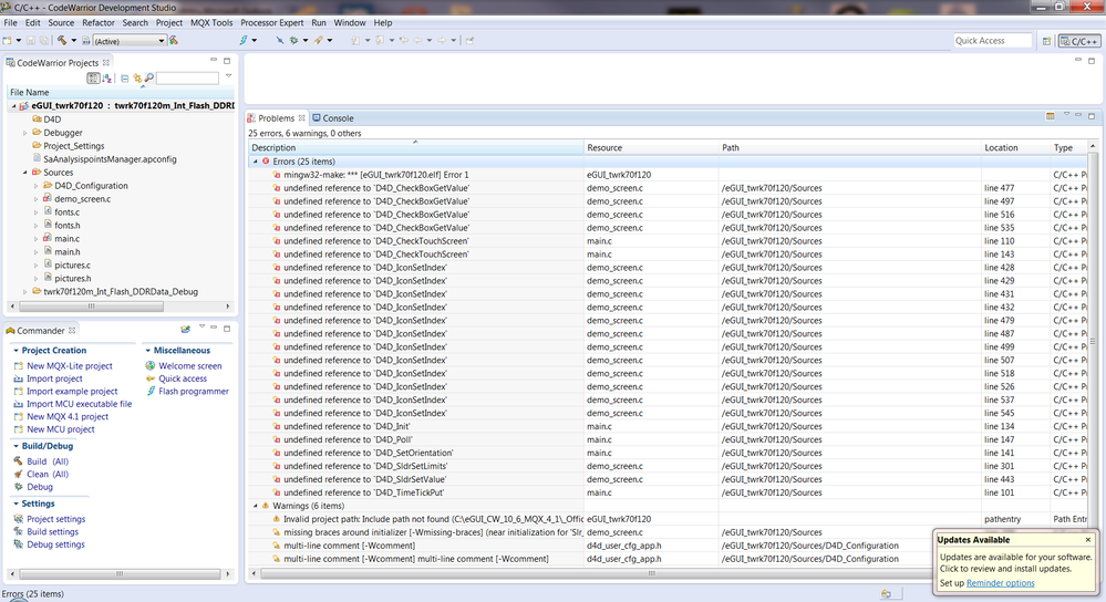

elisamejia
Hi all,
I've been having the same problem. Using CW 10.6 with MQX 4.1 and K70 I get exactly 25 errors:
DescriptionResourcePathLocationType
undefined reference to `D4D_IconSetIndex'demo_screen.c/eGUI_twrk70f120/Sourcesline 545C/C++ Problem
undefined reference to `D4D_CheckBoxGetValue'demo_screen.c/eGUI_twrk70f120/Sourcesline 535C/C++ Problem
mingw32-make: *** [eGUI_twrk70f120.elf] Error 1eGUI_twrk70f120C/C++ Problem
undefined reference to `D4D_IconSetIndex'demo_screen.c/eGUI_twrk70f120/Sourcesline 537C/C++ Problem
undefined reference to `D4D_IconSetIndex'demo_screen.c/eGUI_twrk70f120/Sourcesline 518C/C++ Problem
undefined reference to `D4D_IconSetIndex'demo_screen.c/eGUI_twrk70f120/Sourcesline 526C/C++ Problem
undefined reference to `D4D_IconSetIndex'demo_screen.c/eGUI_twrk70f120/Sourcesline 507C/C++ Problem
undefined reference to `D4D_CheckBoxGetValue'demo_screen.c/eGUI_twrk70f120/Sourcesline 516C/C++ Problem
undefined reference to `D4D_IconSetIndex'demo_screen.c/eGUI_twrk70f120/Sourcesline 499C/C++ Problem
undefined reference to `D4D_Poll'main.c/eGUI_twrk70f120/Sourcesline 147C/C++ Problem
undefined reference to `D4D_CheckBoxGetValue'demo_screen.c/eGUI_twrk70f120/Sourcesline 497C/C++ Problem
undefined reference to `D4D_IconSetIndex'demo_screen.c/eGUI_twrk70f120/Sourcesline 487C/C++ Problem
undefined reference to `D4D_IconSetIndex'demo_screen.c/eGUI_twrk70f120/Sourcesline 479C/C++ Problem
undefined reference to `D4D_CheckTouchScreen'main.c/eGUI_twrk70f120/Sourcesline 110C/C++ Problem
undefined reference to `D4D_CheckBoxGetValue'demo_screen.c/eGUI_twrk70f120/Sourcesline 477C/C++ Problem
undefined reference to `D4D_Init'main.c/eGUI_twrk70f120/Sourcesline 134C/C++ Problem
undefined reference to `D4D_SldrSetValue'demo_screen.c/eGUI_twrk70f120/Sourcesline 443C/C++ Problem
undefined reference to `D4D_IconSetIndex'demo_screen.c/eGUI_twrk70f120/Sourcesline 432C/C++ Problem
undefined reference to `D4D_SetOrientation'main.c/eGUI_twrk70f120/Sourcesline 141C/C++ Problem
undefined reference to `D4D_IconSetIndex'demo_screen.c/eGUI_twrk70f120/Sourcesline 431C/C++ Problem
undefined reference to `D4D_CheckTouchScreen'main.c/eGUI_twrk70f120/Sourcesline 143C/C++ Problem
undefined reference to `D4D_IconSetIndex'demo_screen.c/eGUI_twrk70f120/Sourcesline 429C/C++ Problem
undefined reference to `D4D_IconSetIndex'demo_screen.c/eGUI_twrk70f120/Sourcesline 428C/C++ Problem
undefined reference to `D4D_SldrSetLimits'demo_screen.c/eGUI_twrk70f120/Sourcesline 301C/C++ Problem
undefined reference to `D4D_TimeTickPut'main.c/eGUI_twrk70f120/Sourcesline 101C/C++ Problem
I have built the psp and bsp files after configuring the user_config.h file. Can any of you help me?
Thanks!
Elisa

LuisCasado
Frankly speaking, I don't know. It works for me and other people. Try to unzip in a folder without a long path and without spaces in the path, something like c:\test
Luis

LuisCasado
I have just downloaded my project from this threat (just in case). Unziped in a folder. I have build the new MQX 4.1.1 K70 libraries with the attached user_config.h. Then imported the project into CW 10.6 , build and debug without problems. So I have verified the project and that is working with the latest MQX 4.1.1.
With your errors, I am not sure why you get them. Try to use a new and fresh workspace in CW 10.6. And be sure you don't have problems unzipping the project.
Luis
